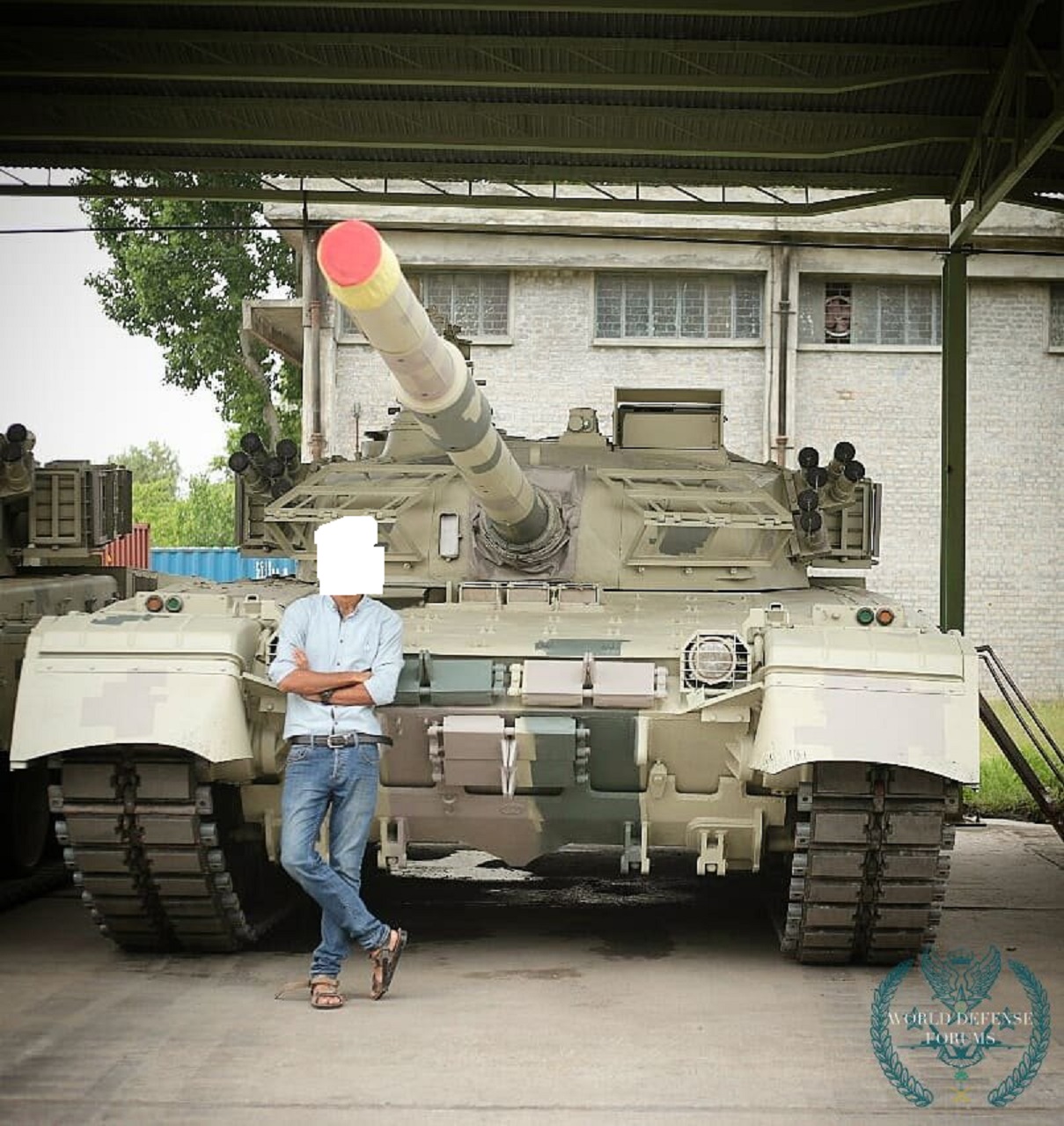

Below are a couple of pictures I took. I get to visit HIT often. This is the same AK from above. It’s permanently there as a display piece. I believe it doesn’t have any of its sensors, nor is the gun and ERA real (all of that is displayed in the back on those tables.) Parked next to it are all of HITs other products. Including An AZ with Full ERA. I’ll see if I can’t find a picture of that later.
