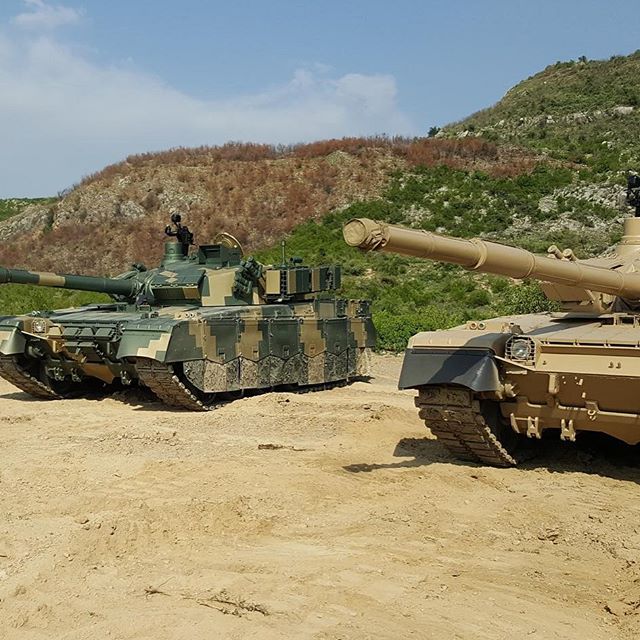

Why this camouflage system wasn’t implemented on the AK-1 and VT-4 ?
Those pictures are from the testing phase of INTERMAT thermal coating on AK.
The coating isn’t the camouflage, the coating can be used with any sort of camo, it is in the paint. Tanks are present In different camos depending on their location, but the thermal coating is already in use on PA tanks.
