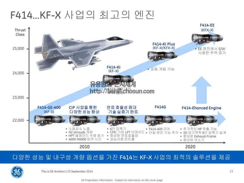

Found this specboard from GE for the KFX, which shows what kind of engines variants might be on offer for them:

Found this specboard from GE for the KFX, which shows what kind of engines variants might be on offer for them:View attachment 185739
so they have different version of KF........so selection of engine will depends on the type of KF is considered
I guess that was a proposal of the initial concept stage and to cover different thrust classes in their offer, but it's clear how interested GE is in that project.
