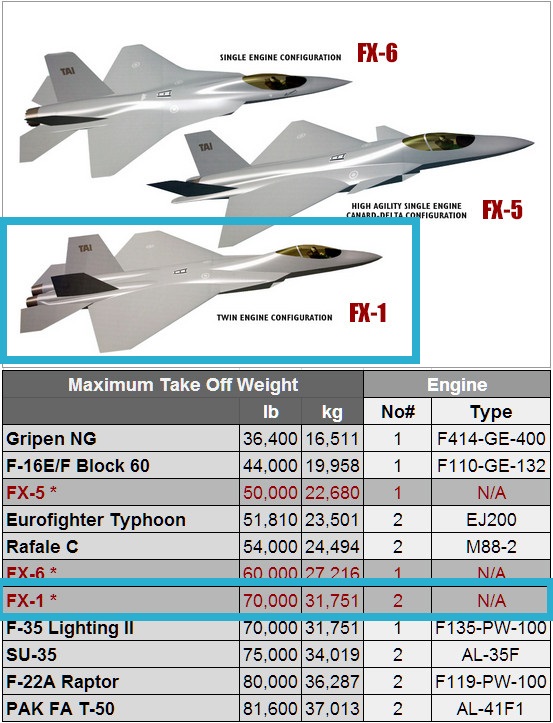

I think i don't understand this engine issue...
TurAF wants twin engines' thrust value to be atleast 70.000...
Now i look at offers with afterburners...
EJ200 => 20.000 x 2 = 40.000
F414-GE-400 => 22.000 x 2 = 44.000
F110-GE-129 => 29.500 x 2 = 59.000
Snecma M88-4E => 17.000 x 2 = 34.000
Snecma M88-ECO => 20.250 x 2 = 40.500
Maybe in the following times
F110-GE-132 => 32.500 x 2 = 65.000
EJ-220 => 23.100 x 2 = 46.200
EJ-230 => 27.000 x 2 = 54.000
As you see all of them are under 70.000... Non of them meet requirements or did i make a mistake about calculating ?.. Can someone explain the issue pls ?..

For one thing thrust value doesn't have to match mtow value.
Read it carefully
70000 lb as maximum take-off weight, not engine trust
FX1 at the same level maximum take-off wieght class with F-35
PW135 has the trust of 43000 lb
So power/weight ratio is 0.614
For F-22 its 2x35000 (F119) /80000=0.875
For that F-35 level power F414-GE-400 or EJ-220 sufficient
To get F-22 power you need 306525 lb powered dual engines like 2*F110
F110 or F119 engines which are large and heavy
For me EJ-230 (27000 lb) or F414 EPE (26000 lb) is better if you decrease weight class to 65000 lb or not

70000 stands for the weight of whole aircraft, not the power of engines together. if this is what you are asking?

So do you say all of these offers meets our requirements ?..
If it is not a big thing can you calculate and write MTOWs with these engines 1 by 1 for 31.751 kg of twin engined FX-1 ?..
