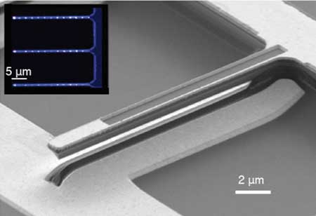

A scanning electron microscope image of a single-crystal diamond cantilever. This tiny device allows scientists to exert control over a quantum system. (© NPG)

They devised a way to increase the strain. They achieved this with a nano-electro-mechanical system device—a single-crystal diamond cantilever with metal electrodes patterned above and below it. An opening in the top electrode allows optical access to the silicon-vacancy qubits. A direct current voltage applied across the electrodes deflects the cantilever downwards and generates controllable static strain. Through strain control, the team reduced the electron-phonon coupling and demonstrated six-fold improvement in the spin coherence time.
