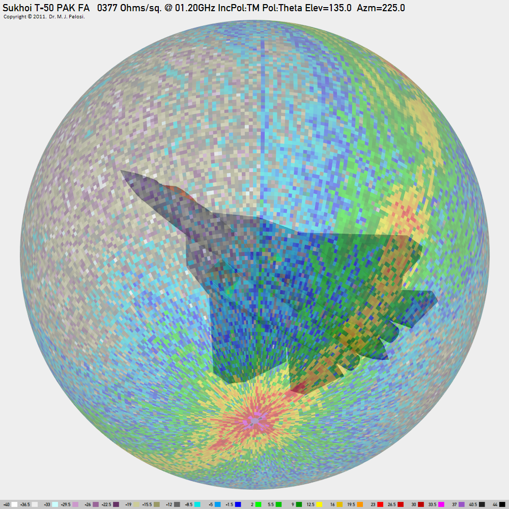

http://www.ausairpower.net/Rus-VLO/...377-IncPol-TM-Pol-Theta-[E=135.0-A=225.0].png
http://www.ausairpower.net/PLA-VLO/...ing-IncPol-TM-Pol-Theta-[E=135.0-A=225.0].png
Some interesting physical optics simulations conducted by Carlo Kopp. What is interesting is that this is a comparison of the J-20 and pak-fa; it has been speculated or proclaimed that the pak-fa is 'not stealthy' especially from underneath by most Chinese.
Both models were tested under the exact same conditions. 1.2 GHz, Elev 135 Azm 225; consequently, the pak-fa is far better in this frequency/angle. Other comparisons under different frequencies/angles shows that sometimes the j-20 is better, sometimes the pak-fa is better, other times they are too close to distinguish either.
