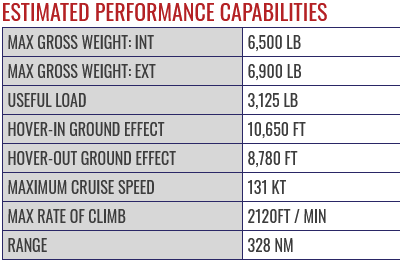

Issue is with load capacity. Can NOTAR handle higher loads?There are other possibilities called NOTAR to counter the torque. I like the trick with the coanda effect there. There are also other kinds of NOTAR.
The only ones using NOTAR is MD Helicopters. No one else, has adopted it.What you mean with "higher loads"?
This is the heaviest NOTAR helo available, which is basically a light twin.
