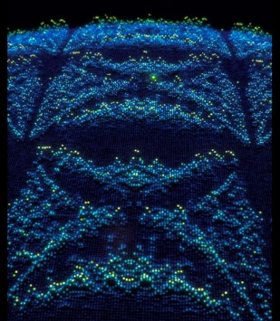

To demonstrate and benchmark their highly tunable nine qubit platform, the researchers caught a butterfly. That is, they used their system to simulate the complicated motion of electrons under a magnetic field, as predicted by physicist Douglas Hofstadter in 1976.
The computational processing power of quantum bits (qubits) is poised to have profound impacts on the diverse fields of science and engineering. Using nine superconducting qubits, researchers at Google and the Centre for Quantum Technologies in Singapore were able to simulate the intricate energy spectrum predicted for 2D electrons in a magnetic field, the Hofstadter Butterfly. This graphic is based on experimental data. (Image: Visual Science and Google, Inc.)
