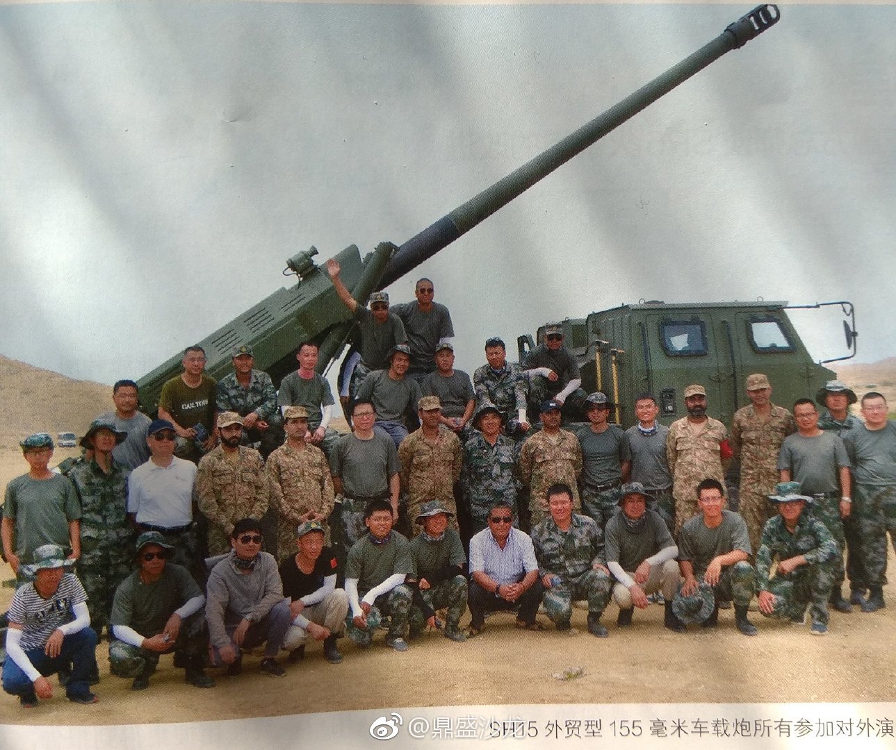

SH-15 Self propelled howitzer under trials by Pakistan army?
