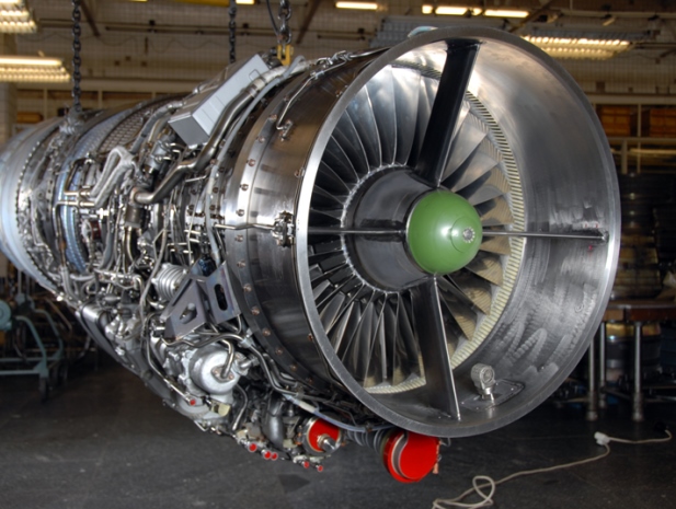

Nice full sized image of the new RD-93MA.
We will only believe if there is a credible source of picture taken from. :enjoy:
Following picture was reported by media outlet. Unfortunately, engine front is covered and direction is different in both pictures even if we try to match parts.
