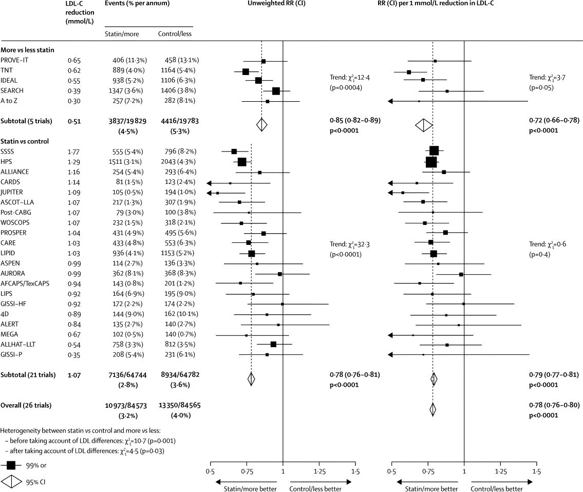

Ok, if I show the evidence you will agree
And which point should I show you the evidence for ?
I will do just one
1-Lower ldl lowers mortality
2- more statins dose lower mortality
There are 136 randomized trials
Below is summary of most popular one
And am not even talking about the pcsk9i trials
Now this undeniable evidence which you will deny and then you say show me evidence?
What kinda idiot am I wasting time??
Atleast don't tell me showe evidence like flat earth believer say.."show me evidence"
