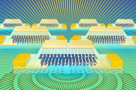

Researchers have designed a light-emitter and detector that can be integrated into silicon CMOS chips. This illustration shows a molybdenum ditelluride light source for silicon photonics. (Image: Sampson Wilcox)
The device is built from a semiconductor material called molybdenum ditelluride. This ultrathin semiconductor belongs to an emerging group of materials known as two-dimensional transition-metal dichalcogenides.
Unlike conventional semiconductors, the material can be stacked on top of silicon wafers, Jarillo-Herrero says.
"Researchers have been trying to find materials that are compatible with silicon, in order to bring optoelectronics and optical communication on-chip, but so far this has proven very difficult," Jarillo-Herrero says. "For example, gallium arsenide is very good for optics, but it cannot be grown on silicon very easily because the two semiconductors are incompatible."
In contrast, the 2-D molybdenum ditelluride can be mechanically attached to any material, Jarillo-Herrero says.
Another difficulty with integrating other semiconductors with silicon is that the materials typically emit light in the visible range, but light at these wavelengths is simply absorbed by silicon.
Molybdenum ditelluride emits light in the infrared range, which is not absorbed by silicon, meaning it can be used for on-chip communication.
To use the material as a light emitter, the researchers first had to convert it into a P-N junction diode, a device in which one side, the P side, is positively charged, while the other, N side, is negatively charged.
In conventional semiconductors, this is typically done by introducing chemical impurities into the material. With the new class of 2-D materials, however, it can be done by simply applying a voltage across metallic gate electrodes placed side-by-side on top of the material.
"That is a significant breakthrough, because it means we do not need to introduce chemical impurities into the material [to create the diode]. We can do it electrically," Jarillo-Herrero says.
Once the diode is produced, the researchers run a current through the device, causing it to emit light.
"So by using diodes made of molybdenum ditelluride, we are able to fabricate light-emitting diodes (LEDs) compatible with silicon chips," Jarillo-Herrero says.
The device can also be switched to operate as a photodetector, by reversing the polarity of the voltage applied to the device. This causes it to stop conducting electricity until a light shines on it, when the current restarts.
In this way, the devices are able to both transmit and receive optical signals.
