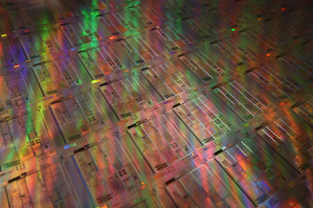

In the latest issue of Nature Photonics ("Electric field-induced second-order nonlinear optical effects in silicon waveguides"), MIT researchers present a practical way to introduce second-order nonlinearities into silicon photonics. They also report prototypes of two different silicon devices that exploit those nonlinearities: a modulator, which encodes data onto an optical beam, and a frequency doubler, a component vital to the development of lasers that can be precisely tuned to a range of different frequencies.
"We now have the ability to have a second-order nonlinearity in silicon, and this is the first real demonstration of that, says Michael Watts, an associate professor of electrical engineering and computer science at MIT. (Image courtesy of the researchers)
