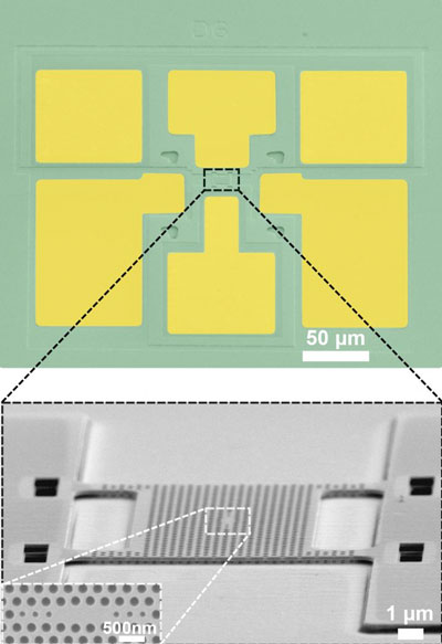

The upper picture shows the entire device; the large yellow areas are contact pads. The lower picture shows the perforated membrane, and the inlay zooms in on the photonic crystal cavity (the area without holes). (Image: Eindhoven University of Technology)
To demonstrate the usefulness, the research team demonstrated several applications, including a gas sensor. They also made an extremely precise motion sensor by making clever use of the fact that the detected frequency changes whenever the two membranes move in relation to each other.
