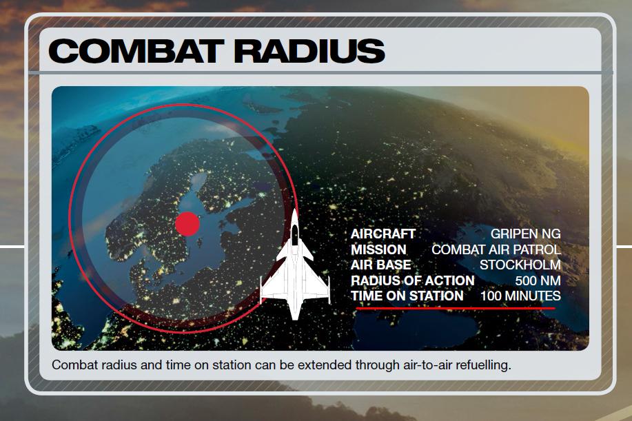

we badly need an aerial refuelling option in JF17s just 1.5 hours loiter time is not good enough for CAP operations.
Gripen NG Combat Radius-1
Euro Fighter Typhoon on Station
thanks for an exceptional input HRK.
However, both the fighters you mentioned the Euro fighter & Gripen have Air to Air Refueling capability. Something the JF-17s badly require currently.
And the JFT will have it in not too distant a future.
Already having those capabilities in block2 don't worry. TV
