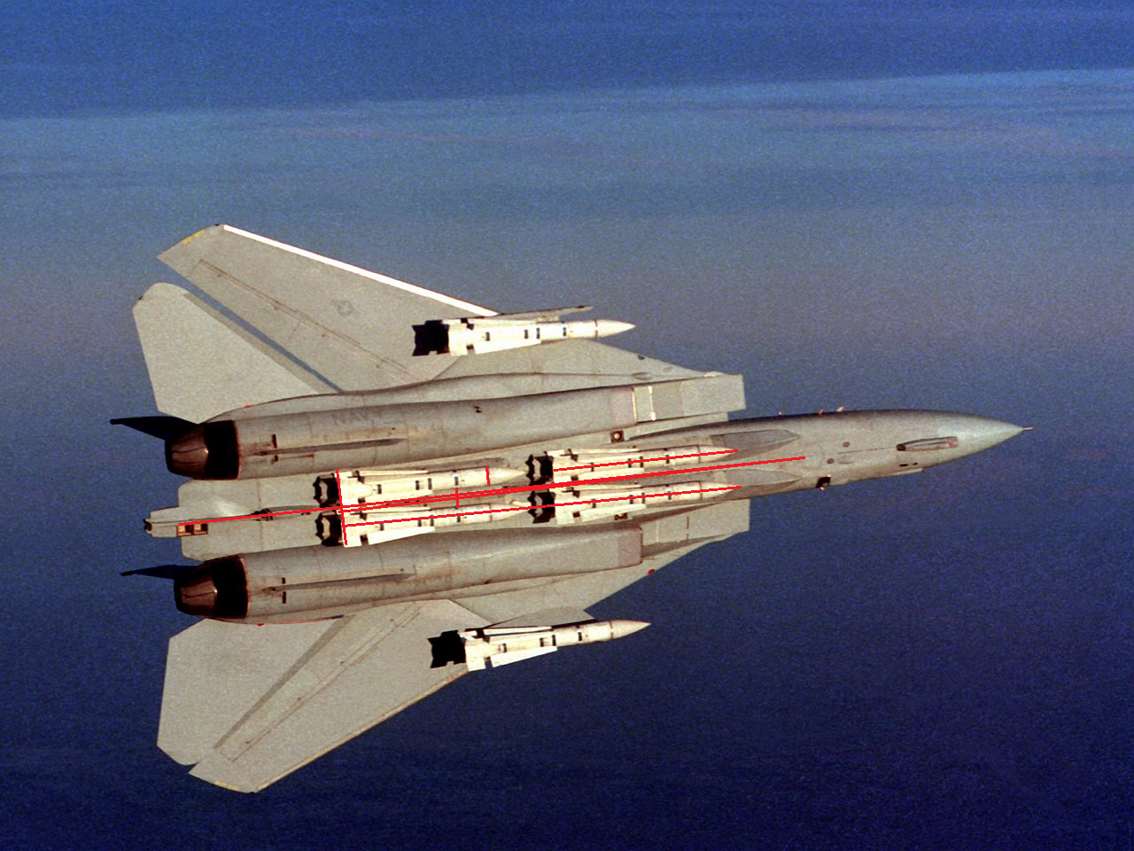

Height that pylon's that F-14 has on the belly hard points is due to wings/tails of the AIM-54 Phoenix.
Specialized pylon that mounts on all four belly hard points can be made considerably shorter than regular.

UAV would not need pylon with coolant for seeker that AIM-54 had for forward mounted on belly that they had.
Another that with AIM-7's length front further back to further forward is over 10 meters, perhaps 11 or 12.
65 centimeter height by 65 centimeter width by 120 centimeter length would have 5 cubic meters.

the pylon will remain 25-30cm whatever you do and please , please please decide its a uav or cruise missile ?

You want to believe that its not possible or viable to reduce height of pylon, as if its unorthodox when there are multiple types of pylons that F-14 has of variable heights.
Did you not complain about AIM-23B / Fakour-90 not being able to be mounted on the belly of F-14? You would never suggest a taller pylon to enable mounting those?
Also I kept with suggestion to have pylon as to be orthodox, yet why not have missile have mounting mechanism of crypto-pylon as part of its air frame body at all?
In a way that makes it conformal and distance between hard points that are right next to each other has at least 60 centimeter gap between each other.
As for mechanism and compactness, AGM-158C LRASM could be taken as an example in design of a cruise missile reminiscent of glide bomb.
Involving calculations, 8 meter long cylinder with diameter of 60 centimeters would have volume of 2.26 cubic meters.
Rectangle shaped body at 8 meter length with 60 centimeter height and width would have volume of 2.88 cubic meters.
207 pixel length for AIM-54 and from tip of front mounted AIM-54 to rear of rear mounted AIM-54 it is 450 pixel length thus gap between two is 36 pixel length.
From value measured with available image that AIM-54 was measured, we can conclude that is 68 centimeters at most, considering perspective, at very least its 50 centimeters.
Its 524 pixel length from rear end of AIM-54 at rear to area where roughly nose landing gear is, that would be 986 centimeters, thus at very least 950 centimeter length is viable.
Diameter of AIM-54 is 20 pixels in width and gap between main body of AIM-54 mounted side by side is also 20 pixels in width thus is 38 centimeter gap between each other.
Width of missile taking into account from one end of wing to another end of wing on another missile is at 80 pixels, thus at most 152 centimeter width under the belly of F-14.
From area where front landing gear is to almost where end of jet engine is at rear, that would be 700 pixel length thus length is at very least over 12.5 meters.
12.5 meter long cylinder at 65 centimeter diameter would have 4.15 cubic meter volume, making that tip aerodynamically viable and then its down to 4 cubit meter volume.
Rectangular body would have 5.28 cubic meter volume, making that aerodynamically viable and that would be down to 5 cubic meter volume.

Distance between pylon / hard point mounting mechanism side by side is around 76 centimeters and total width accounting for tails of AIM-54 missiles is over 150 centimeters.
Either rectangular body with width of 80 or more centimeters or cylindrical body with diameter of 80 or more centimeters mounted on specialized purpose built pylon.
You said that at most on regular pylon that F-14 has that diameter limit would be 52 centimeters, while height of pylon itself is 25 to 30 centimeters.
You know space between pylons is usable thus diameter of cylindrical body could be over 80 centimeters with mounting point on side of it.
Coincidentally it would thus be possible for F-14 to drop 3 ton bomb FAB-3000 equivalent from its belly like Yak-28 interceptor could.

genius the limit is not with the adjacent missile , its with the adjacent engine and with the ground

If missile was mounted same way as AIM-54 then there would be limitation of 52 centimeters that you assert that highest diameter can be used.
You ignore space in between pylons and different way of missile being attached to a pylons or have entirely different pylon design.
