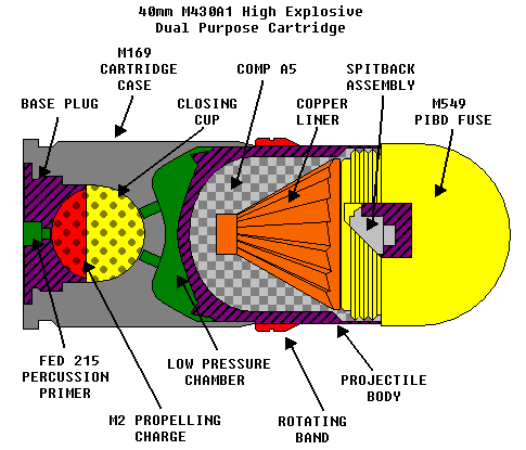

seems to be super effective against thin skinned or lightly armored vehicles but for enemies out in the open for point targets it's not as lethal as you would think it would be.

In the rush to airburst systems, the value of the conventional (and much cheaper) ammunition has not been forgotten. Nammo have developed a ‘product improved’ M430 HEDP round at the request of the USMC, who have asked for a mechanical self-destruct fuze, a modified (NICO type) propulsion system, insensitive munition (IM) properties using a PBXN-11 main charge, additional incendiary after-armour effect, penetration improved from three to four inches of RHA, and a reduced safety zone to prevent the base of projectile from being blown back towards the gunner (the current limitations being 310m in peacetime, 75m in wartime). Internal Nammo qualification of this round is expected in spring 2008.
