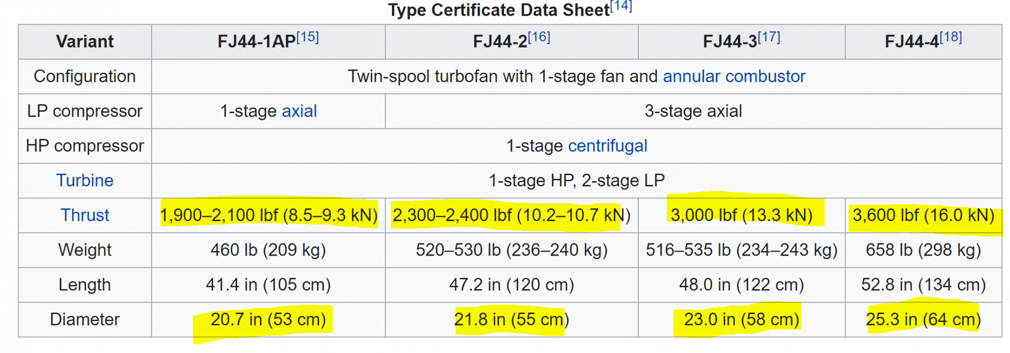

Owj is fuel hungry and is not sufficient for UAVs . what part of it is hard to understand . an airplane with a turbojet engine needs nearly twice as much fuel to do the job that the same airplane with simillar power Turbofan engine needs to do the same job ,
the difference will be like the difference of Mig-25 and Mig-31
going after turbo jet is waste of ressource and there is a lot difference going from Jahesh-700 to something like FJ-44
you want to waste limited fuel your uav carry on after burner. and A UAV with FJ-44 will have twice the endurance of the same UAV with owj then how you claim its absolutely sufficient for uav. your uav is not a suicide UAV so you try make it cheap .

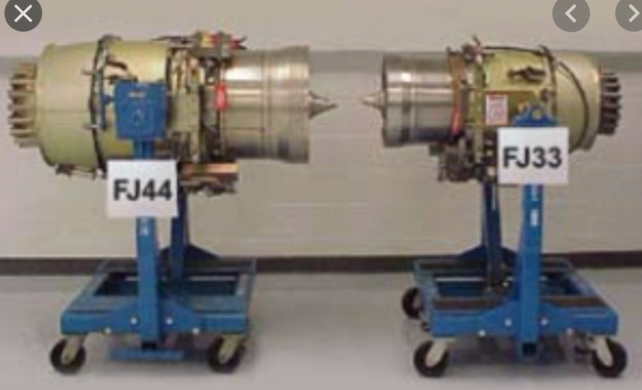

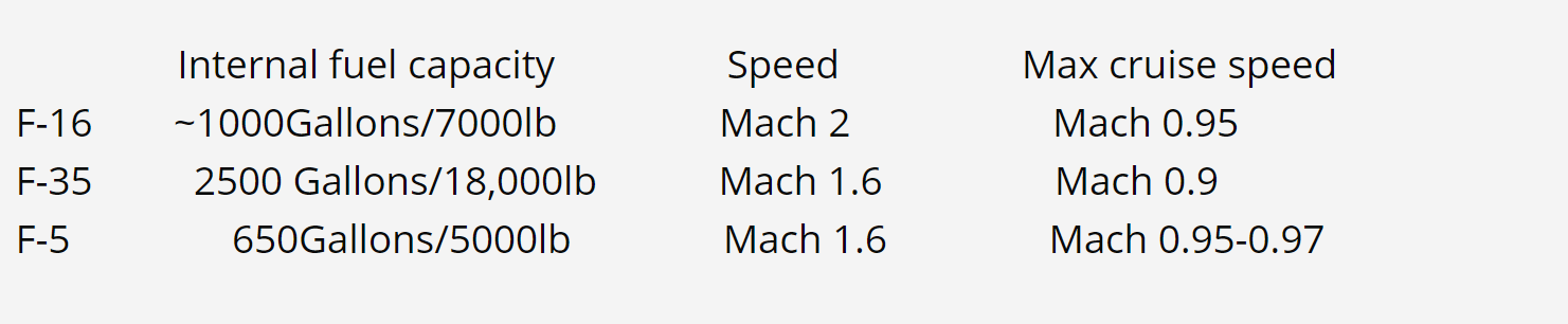

So although per pond of thrust the OWJ is a fuel hungry engine, the platforms you can build around them with sufficient upgrades will at least have a chance to go toe to toe with enemy fighters at shorter ranges.
On top of that, Owj has a lot of room for upgrades and improvements that can further increase it's potential....
By the most part Fj44 is just an enlarged version of the Fj33/Jahesh-700 with a few additional upgrades on the later models
And of course they would be good engines for a high glide flying wing design or a light subsonic jet trainer but it is not now nor will it ever be ideal for a viable supersonic fighter or supersonic ucav....
