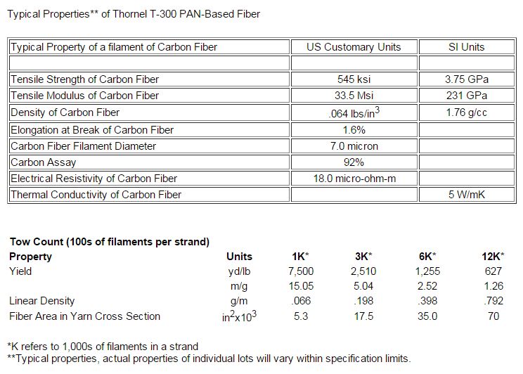

T300:
Baseline carbon fiber used in aerospace applications.
T300 is known for balanced composite properties, high quality and consistency, reliability and availability of supply.
Available in 1K, 3K, 6K and 12K tow sizes.
Carbon fiber classes and weights:
1K
The most intricate weave pattern, for fine detail and complex surface work
Available in plain or twill.
3K The most common weave, used in all industries,from motorsports to robotics and the aerospace industry.
Available in plain and twill weave patterns
12K Heavy-duty fabric, mainly used for flat panels or where structural rigidity is a must (marine,construction)
Available in plain and twill weave patterns.
Technical Data on T-300 PAN-based Carbon
Thermal T300 PAN-Based Carbon Fiber is a standard modulus fiber supplied with 1% UC.309 epoxy-compatible sizing.
T300:
1K
