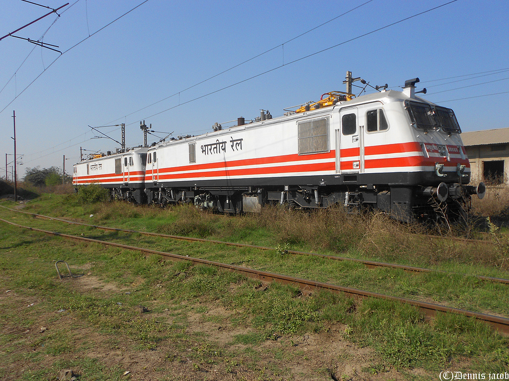

two locos 30071 and 30072 have been shipped from CLW in permanently MUed (Multiple Unit Enabled) configuration. these locos have a single pantograph for each unit and are connected by a common High Tension cable (for power transfer from One pantograph). I saw one last month at Vishwamitri station (Near Vadodra with some unknown train).
This is the factory configuration of MUed WAP 5 and these are proposed for high speed operation of rajdhani class trains (18-20 LHB coaches) at upto 200 kph (track condition permitting).

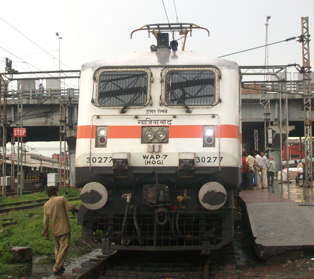

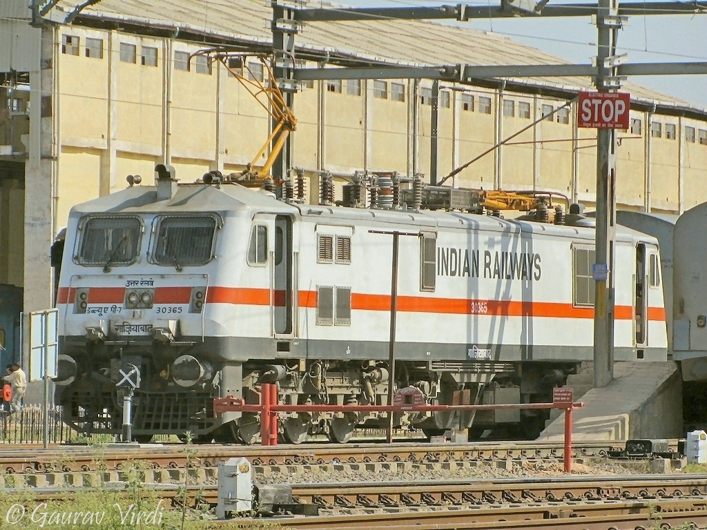

Not necessarily. Head On generation Capability requires an additional convertor that taps off power from Locos main transformer to feed the loads of bogies at 750V. WAP 7 for example has 2*500 KVA single phase convertors but RDSO is trying out these for WAP 4 and WAP 5 as well.
You can identify this feature (Atleast in WAP 7) by looking at side panels, that have additional ventilation opening for the convertors.
