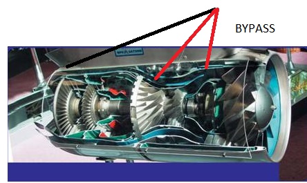

Seems IHS Jane's master experts can't identify a low bypass turbofan engine :
For the people who don't know what a turbofan engine is:
It has a core where the power is generated which in turn spins the shaft. The shaft spins a secondary turbine which may be in front of the engine or around the core in other designs. This turbine is responsible to generate bypass flow around the core which is the main drive force of the engine.
For example:
Turbofan of NPO Saturn used in Kh-59 tactical air launched missile
Oh god.... it couldn't been more wrong....
For the people who don't know what a turbofan engine is, just watch this video.
Attention, this is a high bypass engine...as you can see from the bypass ratios.

What is the type of this engine ?
Ohh, i get it. :)
That's a TurboJet engine..not a TurboFan.
What you are seeing is the low pressure compressor of a TurboJet.
In the TurboFan engines, there would be a a fan before the low pressure compressor, and bypass duct happens to be after the Fan... without a fan, compressor will simply suck all of the air into the engine, that's why A fan is being used to divert some of the airflow into the bypass.
If you photoshop a fan to the entrance , problem will be solved. :enjoy:

Proved your Ignorance :
Good job, by posting another turbofan engine's pic....
What you posted is Ukrainian, Motor Sich's P95TM-300 TurboJet.
https://ru.wikipedia.org/wiki/Р95-300
"korotkoresursny turbojet engine. It also has the designation "Product 95". Designed for installation on subsonic aircraft"
P95TM-300 is the modified version of P95-300.
I guess, i don't have to say which one looks like yours.

Edit: Before you say, that red thingy is not a fan but just a simple cover.

You don't have any picture from the Engine's exhaust !? :rolleyes:
@Sinan
Soumar :
soumar-01-jpg.204613
Р95-300
Разработчик: АМНТК «Союз»
Изготовитель: «Мотор Сич»
Год освоения: 1982
Применение: Х-55, Х-35, Х-59М
малоразмерные одновальные ТРДД тягой 300-380 кгс
R95-300
Developer: AESTC "Union"
The manufacturer: "Motor Sich"
Year of development: 1982
Application: X-55, X-35, X-59M
small-sized single-shaft turbofan thrust of 300-380 kg

In another forum somebody said :
R95-300 is turbofan ... but P95-300 is turbojet !!!
:D
Failure ... P = R in russian :lol:
