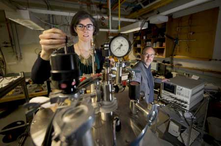

Dr Rose Ahlefeldt and A. Prof Matthew Sellars operating a superconducting magnet cryostat, used in the experiment to generate a high magnetic field and extremely low temperatures. (Image: ANU/cqc2t.org)
