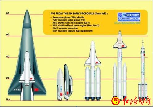

China reopen space craft project after it was postponed decades ago when China was foucused on Shenzhou project, money talks.
And it was “Father of China’s Aerospace”, Qian Xuesen 钱学森 (1911-2009) himself who voted decisively in favour of the continuation of Shenzhou rocket project instead of the more eye-catching and glamour program of reusable spacecraft (akin to the USA' Space Shuttle) when China's aerospace development was presented with two developmental paths: Shenzhou rocket vis-à-vis reusable Spacecraft .
Another wise decision by Qian, like his determined support for the continuation of the China's space medical & health research institute when it's under serious consideration to be dissolved due to funding problem. This space medical institute is instrumental in preparing taikonaut for the manned space flight. Btw it's Qian who decided to adopt the term "aerospace" as the new, proper reference for the entire China's space-related ecosystem.
China was truly fortunate to be granted a great, a genius scientist like Qian Xuesen.
