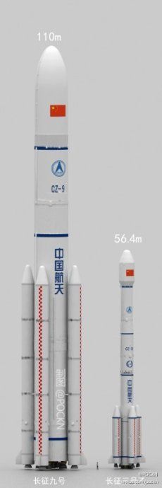

The test booster rocket has ZF-9 painted, so I speculate that it is the booster for CZ-9 rocket, the new heavy weight rocket under development. Also beause it is in development in same time frame as CZ-9 rocket.
From the picture below, we can see that there are 4 booster rockets attached to CZ-9 launch rocket. And each booster has 5 segments ( about 50 metres long). That is quite clear the huge power of these booster rocket.
From the picture below, we can see that there are 4 booster rockets attached to CZ-9 launch rocket. And each booster has 5 segments. That is quite clear the huge power of these booster rocket.
It's unlikely that the designation of a test motor is indicative of its prospective usage. However, it does come as a minor surprise that the CZ-9 team is still considering solid-fueled boosters (or perhaps both liquid- and solid-fueled ones). The consensus was that the CZ-9 were to use a cluster of four YF-500 engines for each booster instead.
