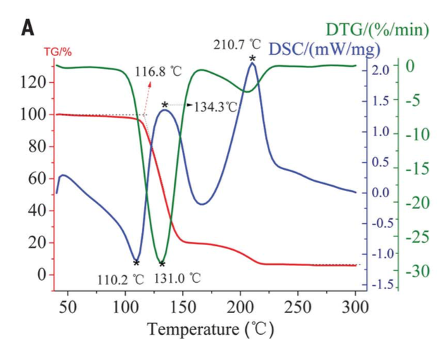

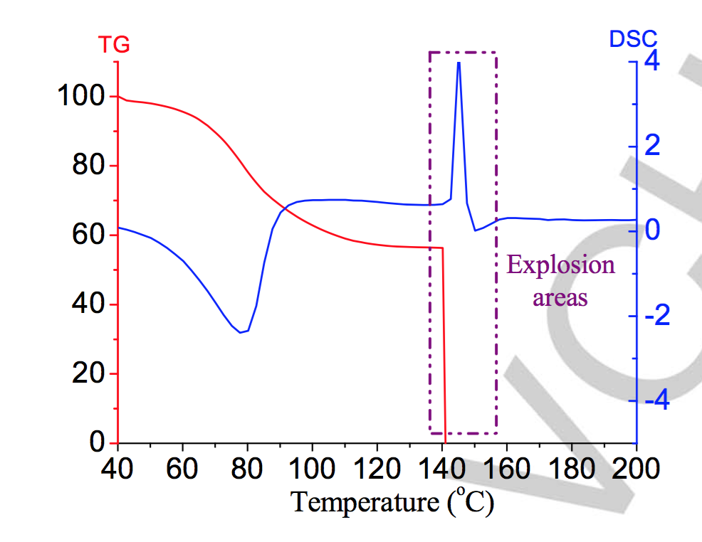

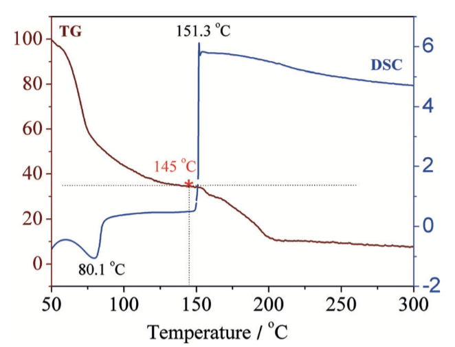

From the Second Paper (for Cobalt complex of cyclo-N5 anion)
From the first paper (DTG DSC TG graph of (N5)6(H3O)3(NH4)4Cl )
All of these plots indicate the kind of decomposition the molecule goes. To actually calculate specific heat of decomposition in J/g, you will need to find the apparatus constant of the equipment by heating a known mass of indium or other sample and comparing the area under curve of that with values in literature. Then you can calculate the specific heat of decomposition by
Hdecom = Area under peak * Apparatus constant.
Now since we do not have access to the equipment nor we have apparatus constant given in these papers the claimed Specific Energy wrt TNT are just wild guesses with no relation to reality.
