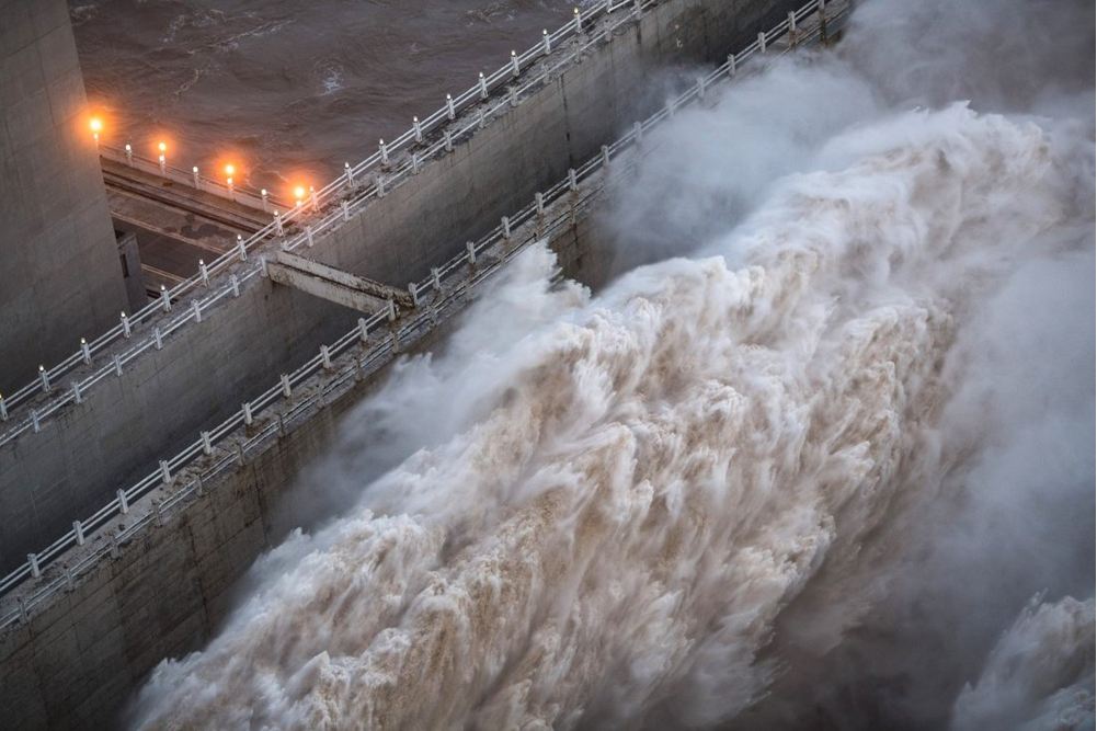

The planned Yinjiangbuhan tunnel will drain water from the Three Gorges Dam, pictured, to the Han River, a major tributary of the Yangtze. Photo: Xinhua
China has launched a new tunnelling project to send water from the Three Gorges Dam to Beijing as part of a massive infrastructure plan to boost food production and the economy.
The Yinjiangbuhan tunnel will drain water from the Three Gorges – the world’s largest dam – to the Han River, a major tributary of the Yangtze River.

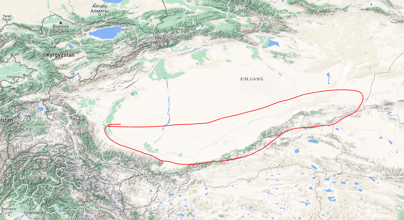

I am a strong supporter of Yaluzangbu transfer to Xinjiang. The red area below South Xinjiang has good sunlight and temperature of Paris. It can be extremely fertile and hospitable to living if there is enough water.

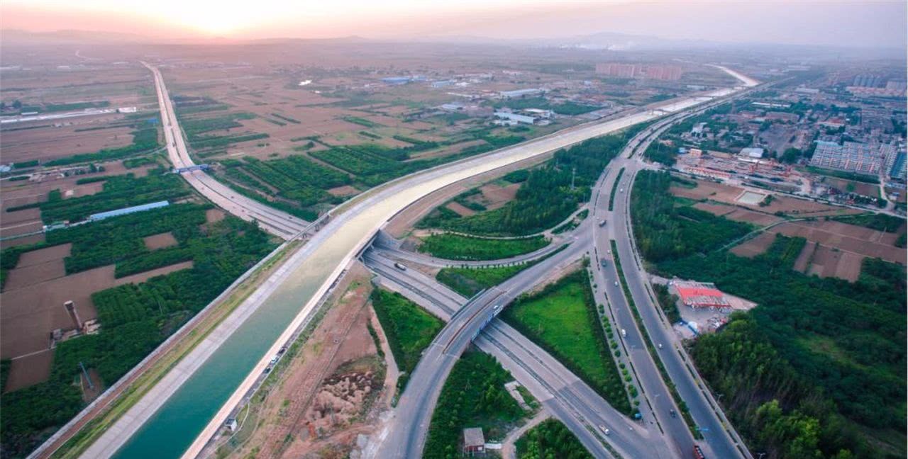

#引汉济渭工程正式向西安通水##西安人喝上汉江水# 今天7月16日上午,历经十余年艰苦奋斗,国家重大水利工程——引汉济渭工程成功实现先期通水,汉江清流穿越秦岭润泽秦川大地的美好愿望成为现实,长江和黄河在关中大地握手。工程受水区域总面积1.4万平方公里,受益人口1411万人。(人民日报)​
Heyday
23-7-16 13:41 Posted in Jiangxi
By ZTE Axon 40 Ultra
【Yinhan Jiwei Project Officially Delivers Water to Xi'an】
"Xi'an people drink water from the Han River"
Today, on the morning of July 16, after more than ten years of hard work, the Yinhan Jiwei Project, a major national water conservancy project, successfully realized the early opening of water. . The total area of the water receiving area of the project is 14,000 square kilometers, benefiting a population of 14.11 million. (People's Daily)
