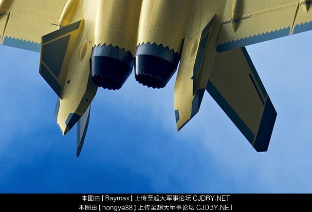

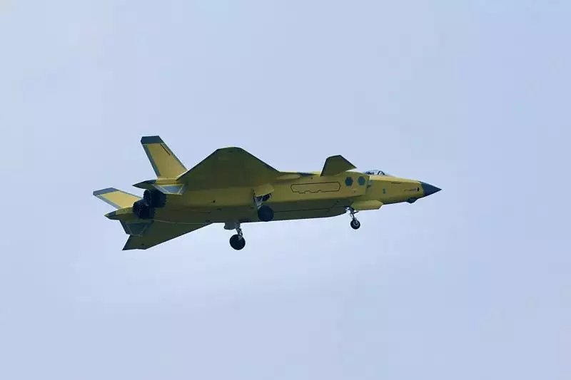

It was a typical aileron roll for airshow. An aileron roll is the most simple of rolls. In simpler aircrafts, like the Cessna 152 I trained on while in high school prior to the USAF, an aileron roll requires three actions: control (or yoke) to either with starboard or port, slight throttle increase, and slight rudder. In flight, every time you make a maneuver, you lose a bit of airspeed, hence the slight increase in throttle.
In avionics, flight control surface deflection is the result of the algorithm of command, airspeed, altitude, gyroscope, and accelerometer. The slower the airspeed, the greater the VISIBILITY of that deflection. So for the J-20 video, the fact that we can see the port vertical stab's high deflection at timestamp 00:10 mean airspeed just above stall, not cruise. After all, it was an airshow and airshow's airspace are designed to be limited.
The FLCC received a cockpit command. The Central Air Data Computer (CADC) sends airspeed and altitude data to the FLCC. The three rate gyros (pitch, roll, and yaw) sends their data to the FLCC, and the two accelerometers sends their data to the FLCC. Then the FLCC calculate the rate and final angle of displacement for the flight control surfaces. The higher the airspeed, the less surface deflection. Conversely, the lower the airspeed, the higher the deflection. So for us to see the deflection at timestamp 00:10, it means airshow airspeed. As the J-20 continues its aileron roll, the jet's AOA, to me, indicates a slight pitch askew (diagonal), further evidence of a lower airspeed than usual. The asymmetrical deflection of the various flight control surfaces is evidence of a computerized flight controls system (FLCS). Not necessarily all fly-by-wire, but for starter, at least a computerized FLCS. For the J-20, the public was informed of a FBW-FLCS.

My simple question was indeed about what maneuver the J-20 was doing in that twitter picture, and when talking about how I've never seen such an asymmetrical tail position, what I meant was I've never seen a tail position in which the vertical stabilizers are facing the same direction but one is in a slightly different angle than the other. I am fully aware of how vertical stabilizers work, and I am fully aware of what a slanted-angle all-moving V-tail is, I was simply asking about the J-20 in the twitter pic and what maneuver it was executing to have its tail position be in an asymmetrical way.
My bet is that similar to how a F-16 utilises differential horizontal stabilisers to help with roll maneuver, the J-20 uses differential vertical stabilisers to increase roll control efficiency while at the same time uses it as an ARI (Aileron-Rudder Interconnect) to minimize side-slip.
Here you can find the F-16 FLCS block diagram for both analog and digital one (DFLCS): http://i.imgur.com/9XKCGrD.png, https://archive.org/details/DTIC_ADA189675/page/n39
Note that how pitch control output is mixed with roll control output. And also the section of Aileron-Rudder Interconnect where rudder deflection (automatically controlled by FLCS) syncs with aileron deflection and it increases as Angle of Attack (AOA) increases. The ARI is designed to minimize side-slip and make the jet roll around its velocity vector so that best roll performance can be attained.
