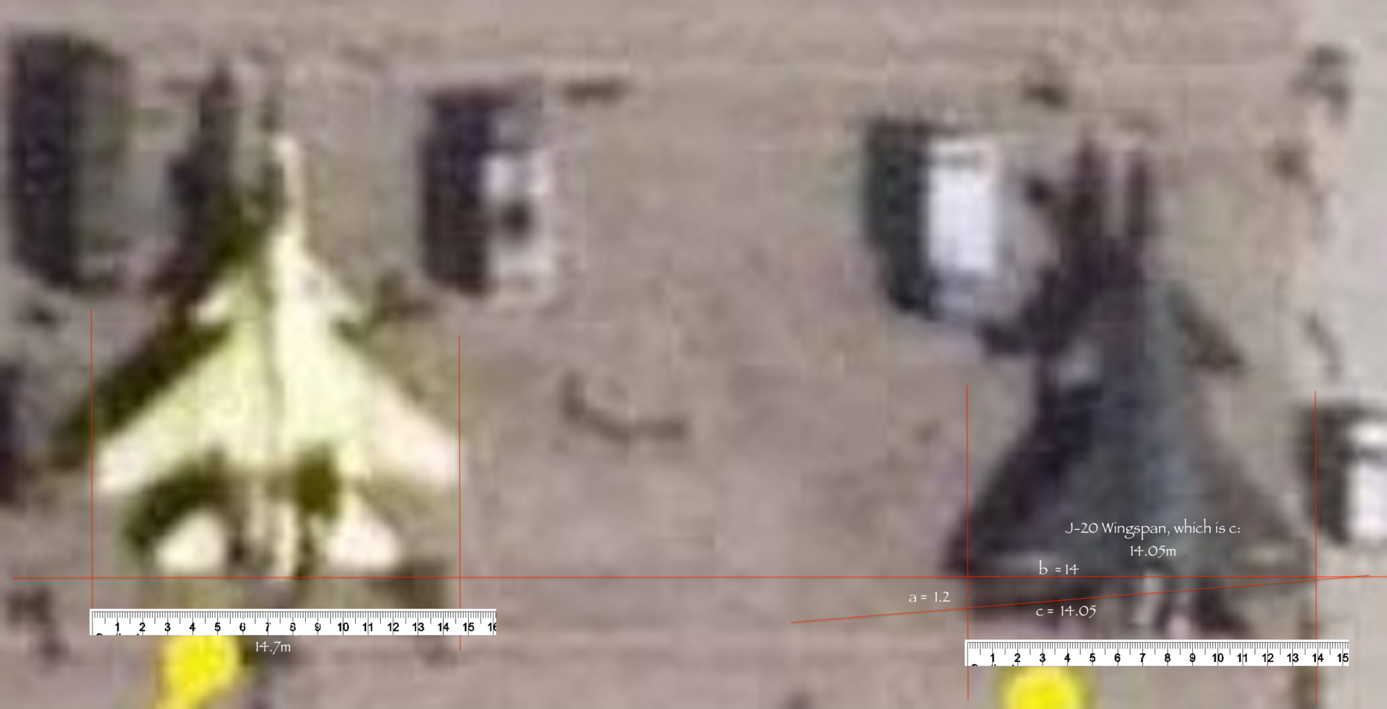

1.) Just as I thought I was done with figuring out the length and width of J-20, I have a persistent urge to verify and confirm, whether the actual wingspan of J-20 is: 13.47m, as stated in the blurry low resolution satellite picture.
2.) To improve the possibility of a better estimate, I took the blurry picture, which was only about 300 pixels across, and resized it to 800%.
3.) This would allow me to view the resultant picture, across my 27 Inch screen, in its new size, and apply the thinnest red lines, that the iMac Preview would allow.
4.) Using the J-15's wingspan of 14.7m as scale, I resized the Metric meter, so the 14.7m falls exactly between the redlines of J-25's wingspan.
5.) I then copied the metric meter image and applied it to the J-20 wingspan.
6.) It yielded the new wingspan value of 14.0m for J-20, which is about 58cm longer than the old value of 13.47m.
7.) I noticed that J-20 was not parked exactly parallel to J-15, but slightly tilted to the left. So I used the Pythagorean theorem to adjust the value to 14.05m.
8.) J-15's wingspan is indeed longer than J-20's wingspan, but its only 0.42m longer, not 1.10m.
9.) The new wingspan values still have rooms for doubts or improvement, since the estimate is based on original low resolution satellite picture, that is extremely blurry.
Intesting approach but why not simply calculating the J-20's length directly from this enlarged image?
IMO sizing the image to calculate span only to then resize and upscale another image adds a larger margin of error than to measure directly.

The wingspan is clearly delineated even in this blurry image, but the nose and nozzle area are simply too indistinct to apply the thin red lines.
Once, we got the wingspan, and assuming it stays the same, we could obtain the length from other pictures. I noticed that the later models has a longer tailboom, than version 2001.

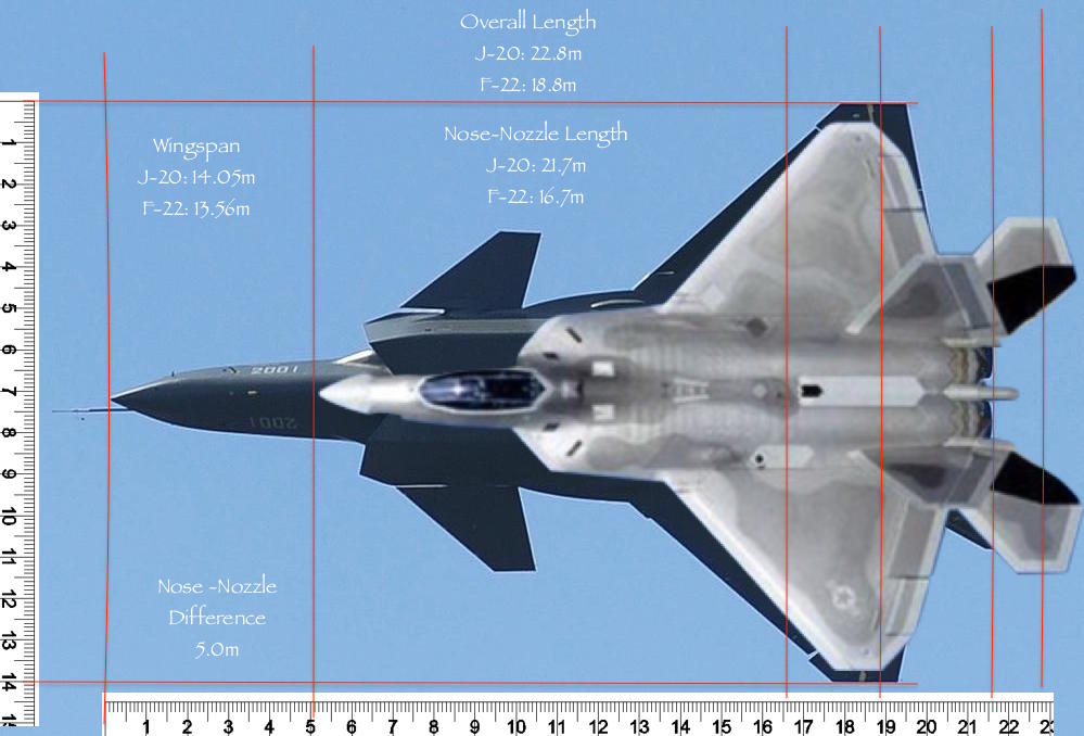

1.) By using the new wingspan estimate of 14.05m for J-20, I applied the same method to find the length as before.
2.) This yielded the following:
a.) Overall Length, J-20: 22.8m, F-22: 18.8m, Difference: 4.0m, or 21.3% longer
b.) Nose to Nozzle length, J-20: 21.7m, F-22: 16.7m, Difference: 5.0m, or 29.94% longer
That is from nose to nozzle J-20 is 5 meters, or nearly 30% longer than F-22.
Those extra 5 meters long fuselage could give J-20 enormous volume to store extra internal fuel.

The new LRIP's model dimension is basically the same as the version 2001. The difference is that the LRIP has a noticeably longer tailboom extended past the canted vertical tail, and that gives it a slightly longer overall length.
The Nose and Nozzle length stays the same.
In the picture above, I did not copy and past an image of a metric ruler onto the J-20, since I can not rotate the ruler precisely to align with the red lines. iMac's Preview program only allows me to rotate left or right, not at a precise angle.
I basically measure the wingspan, nose and nozzle length, and overall length, with a tape measure, on my computer screen, and then compute their ratios and multiple it with the wingspan value of 14.05m.
It's easy to see that the new LRIP birds have a longer tailboom than version 2001, so that its overall length has increased from to 22.8m to 23.06m
"Even if a direct measurement from that grainy image would include an error it would never ever result in a length larger than the J-15 exactly standing a few meters aside ...."
As I have said before, The nose and nozzle areas are so indistinct, I have absolutely no confidence of the lengths, obtained from the satellite pictures.
I challenge everyone to verify the my findings, by using the wingspan of 14.05m obtained from the satellite picture, and then use the same picture, I have used, and follow the same procedures, i have used, to obtain the lengths of J-20.
Note: it's very important to keep the dimension, in the same proportion, as you resize a picture. Drag only by the corners, not along the width or length.

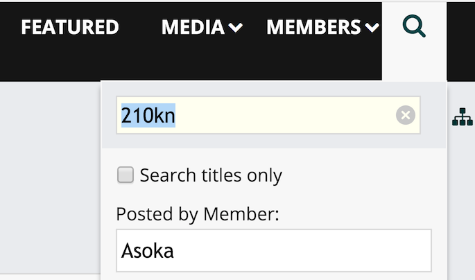

Oh good, I finally have someone, who knows jet engine, to talk about jet engines, with me. I hope you are honest with your qualifications. I have no formal training or working experiences, in aeronautical engineering.
I am self-taught, by reading everything, I can find on jet engines and particularly WS-15, and my learning is only 1 year long, so far.
I have posted my reasoning on how I arrived at the figure 210kN, many times already. If you search "210kN" and posts made by me, you will have many hits.

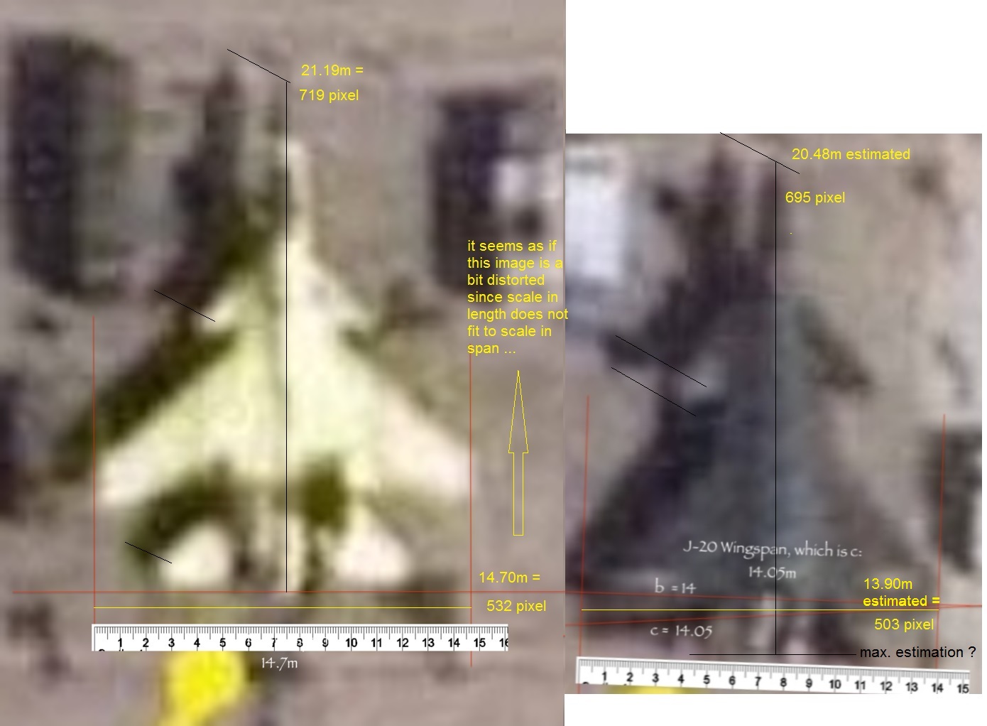

Again; Your estimation is plain wrong and I think I only answer Your false estimation since it includes at least a good start.
So .. even if blurred and surely not exactly the same angle, I used Your fine-rotated J-20 and set it exactly besides the J-15. It seems as if this GE image seems to be a bit distorted in length to span, since given the span-calculation the J-15 should be 792 pixels long, what simply never fits.
Therefore I used the same scale in pan to calculate the J-20's span and the J-15's length to calculate the J-20's length, which in order to give a few feet by were set quite long behind the nozzle. I order to estimate the length I used a few characteristic shadows which must be angled the same and come to the following estimations/calculations:
Span 13.90m
Length 20.48m
FACT again: the J-20

Your finding of the J-20's wingspan to be 13.9m, I have no problem with. The difference is within the error of margin with my finding of 14.05m.
I still have great reservations about, where to place the lines, on the nose and on the tail. It's just too blurry on those area. Sorry. I don't have any confidence on the lengths obtained from the satellite.
I am glad to see that you are trying to confirm or disprove my findings by actual researches.
