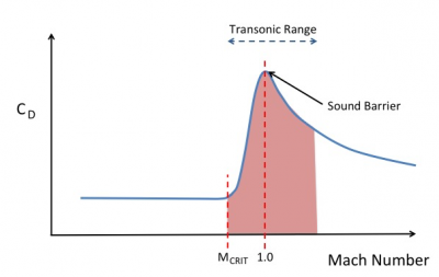

1.) Supersonic Cruise is commonly described as the ability to cruise at Mach 1.4 for at least 30 min, without the use of Afterburner.
Why not define just Supersonic Cruise as cruising just above Mach 1.0?
Because, due to shock wave, the drag in the transonic region, rises dramatically near Mach 0.8, and peaked at Mach 1.0, then drop gradually as speed goes up, and then rise again near Mach 2.
So, it's actually requires less power to fly, if you stay out of this transonic region.
"For all we know J-20 may only be able to supercruise at mach 1.0 or mach 1.1!"
So to tell a pilot to supercruise at Mach 1.0 or Mach 1.1 is simply ridiculous. You don't know what are you talking about.
2. "the pilot never mentions anything about supercruise, only that the aircraft's supersonic maneuverability is very good."
Yes, he didn't mention anything about supersonic cruise. He only unmistakably confirmed that J-20's supersonic maneuverability is outstanding.
However, what's maneuver at supersonic speed like, while you have to turn on the Afterburner?
It means you have to burn several times more fuel, while you are making violent maneuvers, which bleeds off your speed or energy quickly, and you must push the throttle to quickly replenish it.
While at subsonic speed, this is already bad enough. Most fighters have only several minutes of extra fuel to burn, when the Afterburner is engaged. (Remember, they have go to home. You can't burn all your fuel, while fighting)
At supersonic speed, the fuel burn rate is so much worse, if you do violent maneuvers, while engaging the afterburner. You can imagine travel at in car at 50km/h, and open all four car doors or slam on the brakes, suddenly, your car will decelerate quickly. And you have to step on the gas pedal to get back to 50km/h.
Now, you do the same at 100km/h, and also slowed way down, and you have to get back to 100km/h. This time, you have to spend so much energy to get back to 100km/h, because E = 1/2mv(2). That is kinetic energy goes up by the square of the velocity.
So, supersonic maneuverability requires so much more power from the engine, to push the plane to stay above the transonic region. That's why supersonic maneuverability requires a so much more powerful engine, than subsonic maneuverability. Supersonic maneuverability is meaningless if you can't stay above supersonic speed for a few minutes, because you have to engage AB constantly.
It's safe to say, if you have outstanding/world beating supersonic maneuverability, you have a powerful engine to replenish your lost energy quickly, to stay above supersonic for a long while, without AB. If you have to turn on AB, your fuel gauge hits BINGO, very quickly.
And its also safe to say, if have superior supersonic maneuverability, without use of AB, you can do supersonic cruise, without AB, because violent maneuvers requires so much more power than just cruising at constant speed.
If you think you can excellent supersonic maneuverability without the ability of supersonic cruise, you have no idea of what are you talking about.
It's safe to say, if you have outstanding/world beating supersonic maneuverability, you have a powerful engine to replenish your lost energy to stay above supersonic for a long while, without AB.
And its also safe to say, if have superior supersonic maneuverability without AB, you can do supersonic cruise, without AB, because violent maneuvers requires so much more power than just cruising.
