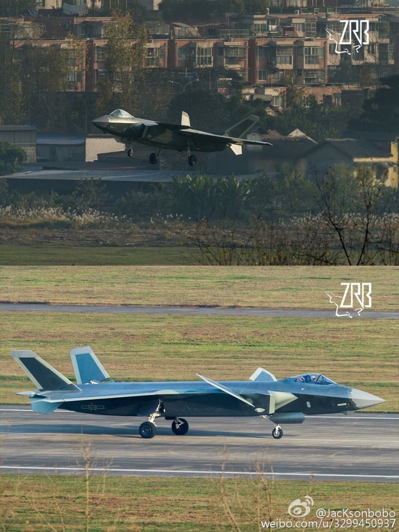

First of all a Happy new Year 2017 to all ...
but then @Asok, earth to @Asok ????!!! Are You still here ... Contact ??? Come on back to reality ...
According to my calculations, if J-20's empty weight is of 22 tons (2 more than F-22, because its body, nose to nozzle, is 10ft or 3m longer), and carries 3 tons of fuel for the testing or demo (25 tons total), assuming dry thrust is 60% of max thrust, it will requires the engine to have > 212kN of maximum thrust, to left the J-20 in an effortless 90 degrees, vertical climb, without the use of afterburner,
WS-15 has already passed 180kN, IMO, and may have already hit 212kN. This is shockingly more powerful than even the most patriotic Chinese, has predicted. But it's really not that surprising, because WS-15 is rumored to be based on the YAK-141's powerful R79-v300 engine, which was rated as 206kN. That was developed in the 1980's by the Soviets.
I know we both do not agree with the engine, but it is one thing to assume a Chinese engine is used, another to state a prototype version of the WS-15 is used ... but now to claim this prototype delivers already about 30 kN more thrust than the planned serial version of the WS-15 is so much off that it is beyond any sense of reality.
Therefore again I admire Your persistence to find out the truth even if I'm still sure that all Your calculations based on these small, grainy and much too short video clips are baseless any rational analysis; I would also accept that we still not know what's going on and we must wait .... but please do not tell us this as a "FACT".
Even more an engine in the range of +200kN is simply off all predictions and technical possibilities ...
So please come back to us...
Deino
Deino
View attachment 365008 View attachment 365009

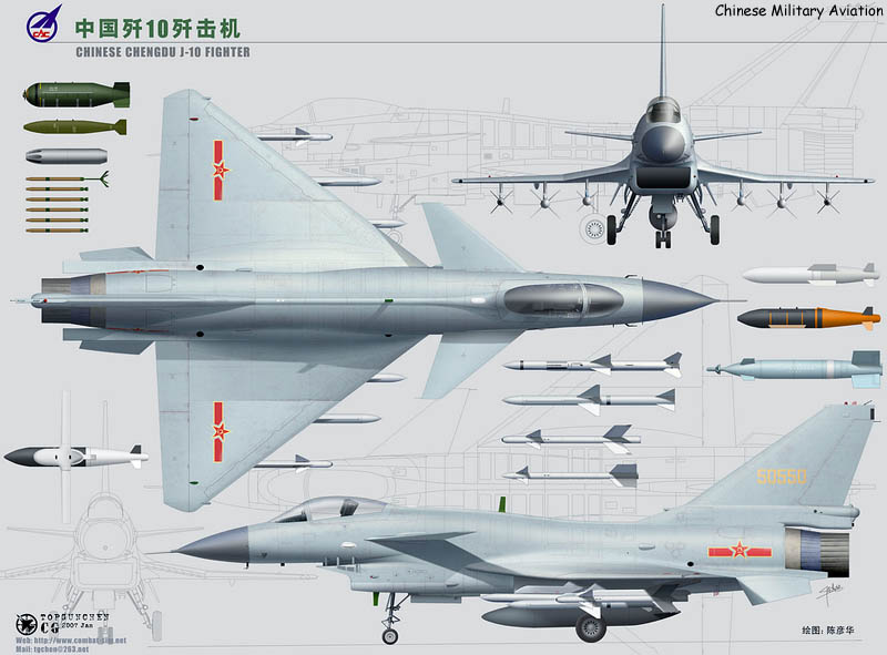

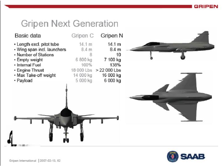

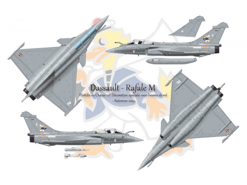

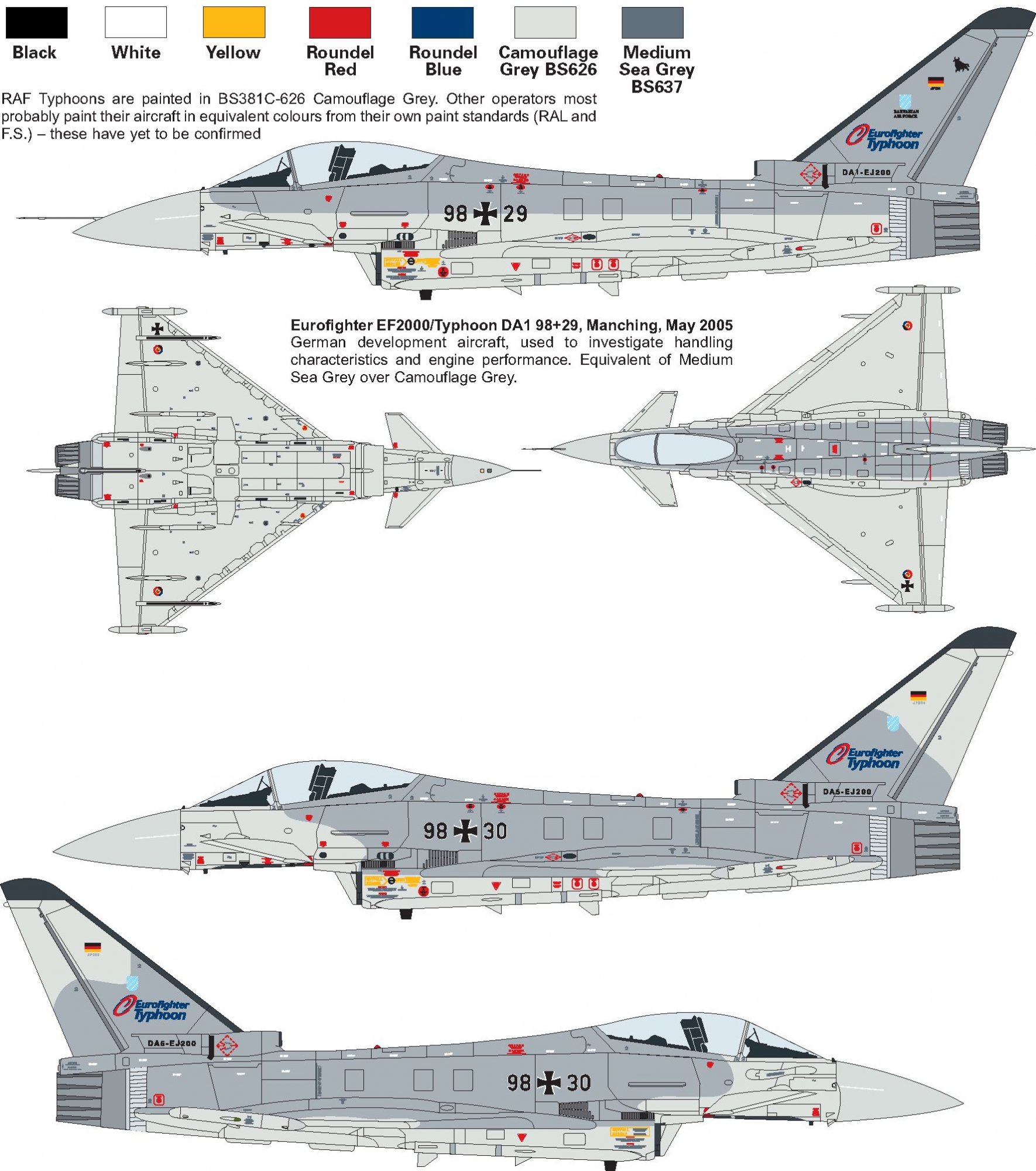

Delta wings jets are built for speed but less agile, if you put Canard in the front Delta wings its CALLED DELTA CANARD PLATFORM has a extreme agility, Delta Canard platform Examples are:
J-20
EF-2000
J-10
RAFALE
GRIPEN

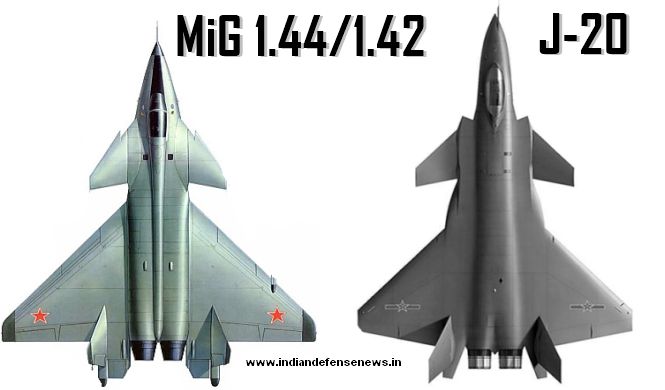

What is talking about that J-20's shape is strikingly similar to Mig-25:hitwall::disagree: J-20 is more resembles MIG-1.44 than MIG-25 take a look
J-20 and MIG1.44 comparison

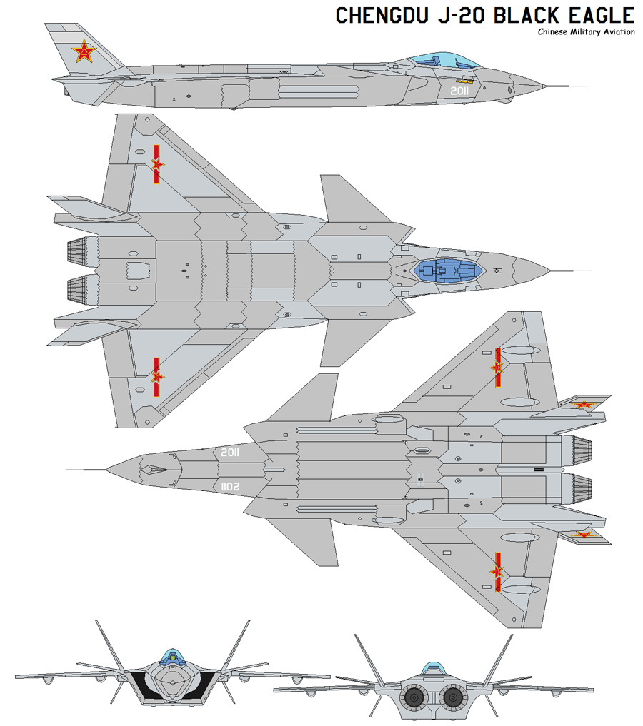

J-20's shape is strikingly similar to Mig-25 and the cancelled Chinese J-9 interceptor.
Do you even know the meaning/context of the word 'strikingly' ?
To us 'strikingly' is to say something is extraordinary. If you are going to use the word in a visual comparison between objects, you are saying these objects looks extraordinarily close to each other. Not quite twins, but extraordinarily close to being identical.
The J-20's shape is not close to the MIG-25's.
J-20
View attachment 365199 View attachment 365200 EF-2000
J-10
RAFALE
Wow, those
GRIPEN

Wow, those drawings and pictures are brutally beautiful. Thanks for the new year eye candies treat.
"extreme agility" is the right description for the DELTA CANARD PLATFORM.
I say they are. The length, wingspan, and wing angle sweep. J-9, J-20 and Mig-25 are optimized for Supersonic high speed. Just look at the post, I made one or two pages back.
And you are wrong. Simple as that.
no bro they are not, there no confirmed specification of J-20, Just based on images of J-20 which might be wrong biggest difference is J-9 and MIG-25 not a stealth jets
