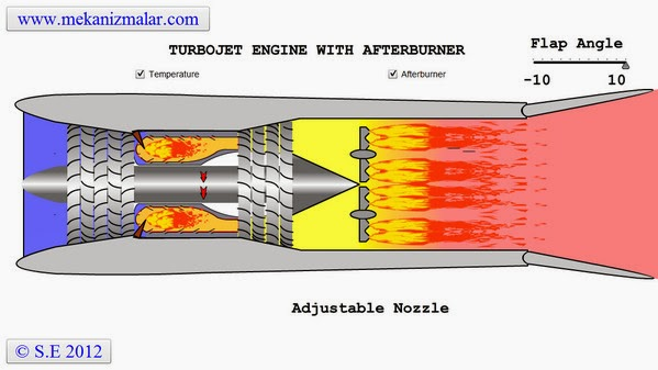

Now, a turbofan jet generates thrust by burning fuel and compressed air in the combustion chamber, this thrust is called Dry Thrust or military power. The pilot could also activate the afterburner and greatly increase the engine's thrust or power.
"Afterburning is achieved by injecting additional fuel into the jet pipe downstream of (i.e. after) the turbine. The advantage of afterburning is significantly increased thrust; the disadvantage is its very high fuel consumption and inefficiency, though this is often regarded as acceptable for the short periods during which it is usually used.
Pilots can activate and deactivate afterburners in-flight, and jet engines are referred to as operating WET when afterburning is being used, and DRY when not.
An engine producing maximum thrust WET is at Maximum Power, while an engine producing maximum thrust DRY is at Military Power". --Wikipedia
So DRY or Military Power is less than WET or Maximum Power. Dry thrust or military power is usually 50-60% of Wet or Maximum Power.
