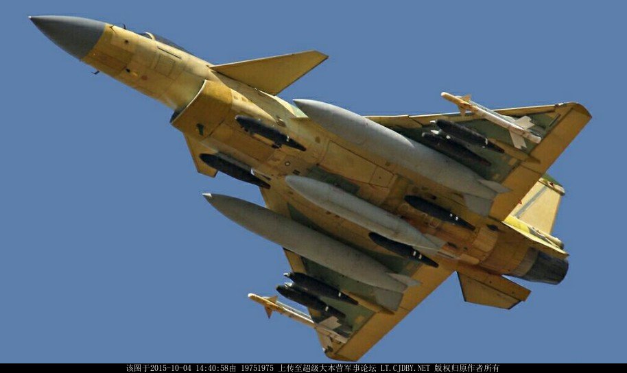

Of course they can, the 3rd underwing pylon can carry BVRAAM.
And they can hold up to 12 AAM with dual racks.
Total they have 10 pylon (8 underwing, 1 underbelly, and 1 other near engine intake)
I don't know about underbelly pylon and near engine intake pylon, can carry AAM too or not. Mostly they carry External Tank and Laser Pod/ Electronic Jamming Pods.
Usually they carry 3 External Tanks in Long Distance Combat Mission.
There is no pylon near fuselage other than centerline pylon reserves for small 150 gallon fuel tank, ECM or targeting pod. The way you explained sounds not convincing because you've never seen it carrying dual rack nor air to air missiles on innermost underwing pylons
You are wrong, there are altogether 4 small pylons - two under the air intake and two on the rear fuselage.

These 4 bvr seems to be attached to the dual rails. Can you please show us any picture of J10 with its full air superiority load? I have suspicions.
As far as i know J10 can only carry 2 BVR and 2 WVR missiles without dual rails. Inner most pylons and fuselage pylons cannot carry BVR's. They can carry fuel tanks or pods only.
If PAF requires that J-10C's Inner most pylons and fuselage pylon should carry BVR AAMs, do you think that CAC would face technology limitations?

Those 4 small pylons could only carry small bombs ordnance, not air to air missiles. Pylon for air to air missiles required longer rail with fast release especially for launching short range IR guided missiles.

I and several know this since years and we also know since years that only the two outmost pylons are capable to use AAMs. At least in operational use I know not a single image showing an AAM mounted on the inner pylon know and the one, but You were saying "There is no pylon near fuselage other than centerline pylon reserves for small 150 gallon fuel tank, ECM or targeting pod" and that is wrong.
That these smaller ones cannot hold AAMs is also well known since years and was never in question.

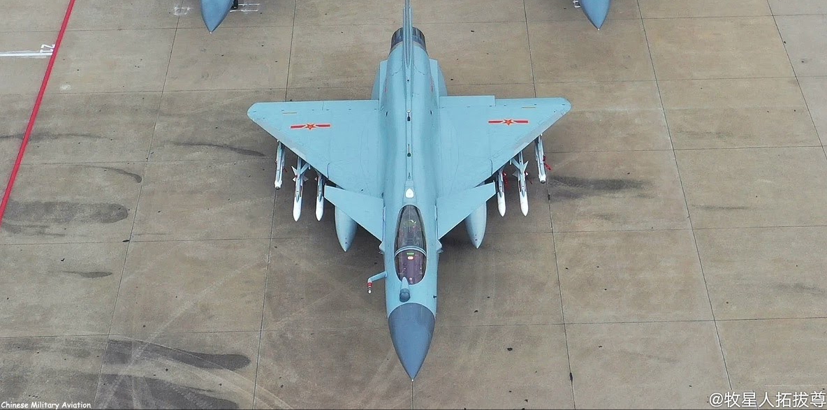

The cold truth is that J10A/B/C's inner "fuel tank only" inner wing pylon has been wired for weapons and electronic pods, and there are photos to support this. It is just that they do not release many photo as normal training sortie has no requirement for armed to the teeth weapon configuration, and China is not in war time operational deployment like US and NATO.
Chinese normally do not do as the West do. In the West, the aircraft manufacturer will show off the best of what they can offer, sometimes even over-stated, in order to compete with each other to sell their aircraft and weapons, in a dog eat dog world. Chinese normally chose not to disclose their full potential as the main customer is domestic. They don't have to do hard sale.
Thus with-out the dual rack pylon, a J10 can carry up to 4 BVRAAM, or 6 if dual rack is used. For 4 J10, that is 16 to 24 BVR missiles. More than enough to kill a full squadron of 16 aircraft as normal kill rates of modern missiles is around 80% or more if the targets are in the kill zone.
Chinese BVRAAM has range beyond 250km, with latest PL-20 and PL-21 said to have range of >350KM and >400KM, though it is unclear what is the kill zone range.
I suspect even the outer most pylon normally fitted with WVRAAM can accommodate BVRAAM, but it is unwise to do so as with-out WVRAAM, one is very likely to lost in a dogfight with gun only.

I think there is some mix of information here so far.
J-10 has always been known by the fans as only equipping missiles on the two outer pylons like Deino said. The maximum PL-12 or PL-15 missile carriage by each J-10 is 4. Most wing end pylon so far has never been seen with medium range missile so only for short range due to weight most likely. Maybe they can carry PL-12 but at least it's never photographed.
Middle wing pylon can carry dual missiles and the drop in performance is not as much as you suggested. If mission require as many PL-15 as possible, dual missile is fine and performance at medium range is okay because very close range kind of turning is not necessary in medium range launch until further into merge.
Rafale is capable of carrying 8 medium range and Typhoon carries about the same for recommended air superiority mission. Typhoon's maximum air superiority mission is 6 medium range and 2 short range with fuel tanks. Rafale's maximum air superiority mission is usually 4 medium or long range Meteor depending on definition of long range and 2 short range with fuel tanks.
https://www.airforce-technology.com/projects/ef2000/
Fuel tanks are always carried in real life and they are dropped when fighting becomes closer ranged or if the plane needs to make very quick turns. They can carry more missiles but if you just want to carry as more missile than your enemy, then the Su and the F-15X will be better.
Definitely agree with you that just 2 medium range is not enough. This is why J-10 can carry 4. If you look at performance of engine compared to Rafale and the weight of each, the J-10 performance when carrying 4 PL-15 is still at better thrust to weight than Rafale with 6 missiles. Of course the Rafale with 6 missiles and three tanks still has 2 more missiles and much better range but it is not a problem and limit of performance with dual missiles.
I really think the J-10's engine and wing can easily deal with 6 medium range and three tanks in total but the performance will definitely not be as good and the wing life may be reduced a lot so even if it can carry just like Rafale can carry 8 or more Meteor and Typhoon can carry 10 AIM-120 but they don't due to fuel tank and performance degradation.
