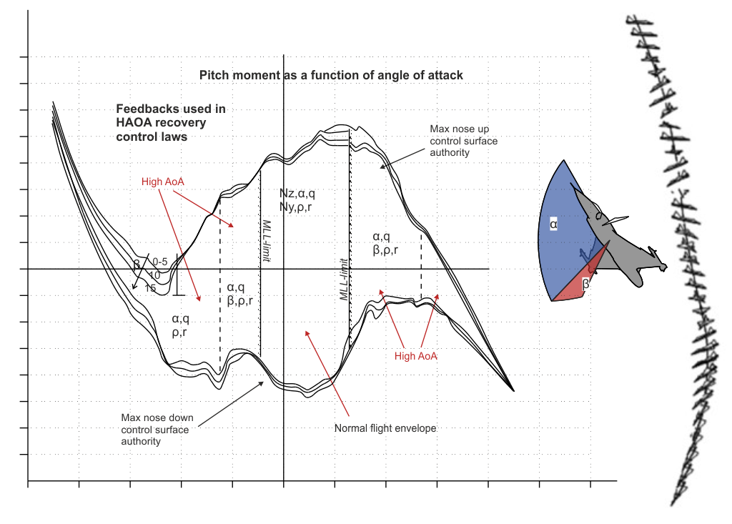

I mean when talking about stability of aircraft, people normally use this assumption: when the center of lift is behind the center of gravity, the aircraft is stable as if a small disturb increases the AOA, the lift increase and try to push the nose down to decrease the AOA. Therefore stabilise the aircraft. If the center of gravity in these canard fighters is in front of the center of lift of the main wing, it looks like a stable plane for me.
Actually it's the slope/gradient of the pitching moment (Cm) curve that defines static longitudinal stability. A RSS aircraft can exhibit both stable and unstable characteristics in different regions of AOA. Take the Cm curve of Jas-39 for example (taken from https://saabaircraftindustry.com/en...l-capability-development-for-control-systems/):
A negative slope means statically stable. And a positive slope means statically unstable.
But then, there's dynamic stability which is another thing.

Very good one. Thanks. So the Y axis is Cm, X axis is AoA (down to -30/40 degree??), the top curve is max nose up control surface limit and the bottom curve is max nose down control surface limit?
