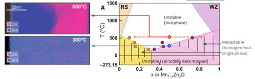

Using computational methods, scientists showed how to mix manganese oxide and zinc oxide to create an alloy with a “sweet spot” (right, blue diamond) where the elements are uniformly mixed (lower left). When synthesized at a higher temperature (right, red diamond), the same material lacks homogeneity (upper left). (Image: National Renewable Energy Laboratory) (click on image to enlarge)
