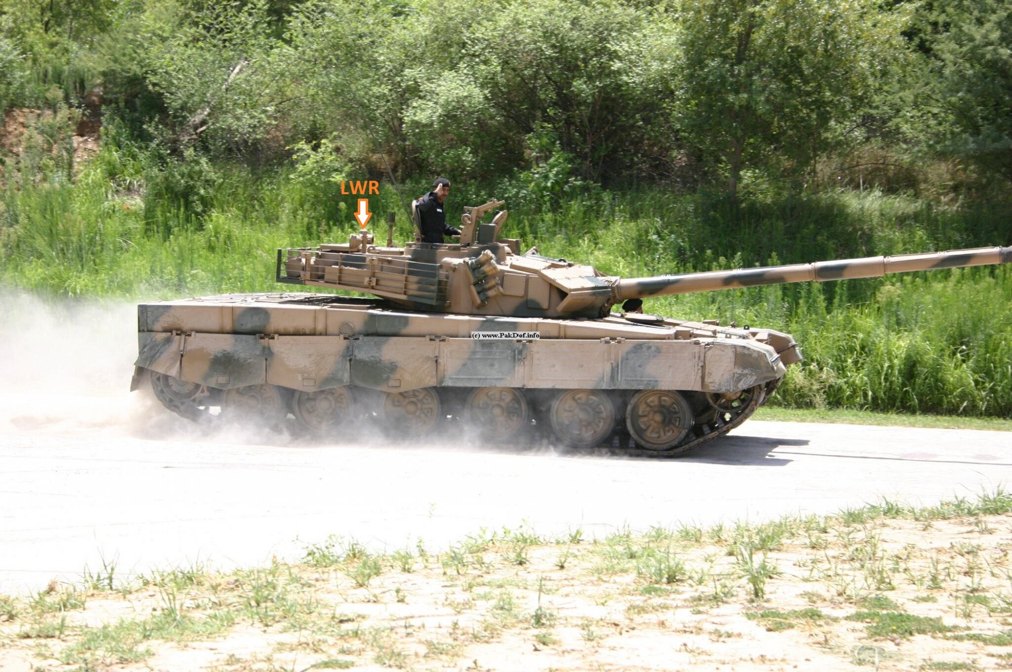

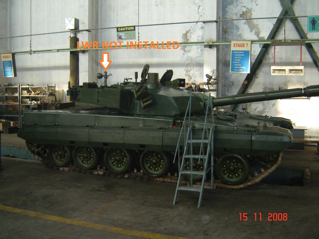

Does anyone have a picture of Laser Warning receivers mounted on AK/AK-1 (as in actually on the tank.)
They are supposedly located behind the 12.7mm gun (which makes no sense, but still.)
Because it’s supposed to have a LWR but they’re not visible anywhere on the turret.
its from GIDS name LTS-786P (Laser Threat Sensor)

I will excuse myself to answer this question as I don't have any source available to back up my understanding that in AK it is for both ....
No worries sir. Thanks a lot for taking the time to response. I’m sure Sir dazzler will tell me eventually.
