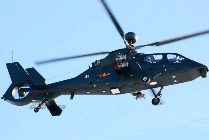

Most likely an old image taken during the hand-over last year.
Z-19 with wave radar act as command and eyes ,staying behind better armour Z-10. Comunicate thru datalink while the Z-10 act as spear going for the kill. That is most likely the scenario. Z-19 acting like AWACS.
Why Z10 can't mount the top MMR? Engine power shortage or cost concern? Will Z10 has to sacrifice weapon load if it has MMR on it?

Why Apache 64 install MMR on every of it?
Do we need to follow blindly everything American has ?
I think it still be the problem of lower engine power output, lets looking foward Turboshaft type 16. The installation of MMR will add around 200 kg plus to the take off weight, means we need to enhance Z10 engine's HP to balance the added weight.we gonna pull it off in the near future. I wanna see every Z10 carrys MMR. Now the reason why Z19
Can carry MMR is because it replace previous Turboshaft 8c to 9A, from700 hp to 1000hp. Z10 with thicker protection armor can't carry MMR without engine performance enhancement, unless we can put better engine on it.
A promotional video from Harbin has revealed the interior of the Z-19 helicopter’s mast-mounted radar.

The millimeter wave (MMW) fire-control radar (FCR) for Z-10 is developed by China Northern Electronic Co. (中国北方电子公司), a subsidiary of Norinco. This MMW FCR is fully solid state and fully digitized, weighing 69.5 kg, less than half of similar former Soviet system.
The Chinese MMW FCR adopts western approach of using a single antenna, similar to AN/APG-78 used for AH-64D Apache Longbow.
The radar is designated as YH, short for Yu Huo (浴火), meaning bathing in fire. YH MMW FCR is fully integrated with other subsystems of the onboard electronic warfare system, such as radar warning receivers (RWR), laser warning receivers (LWR), electronic support measures (ESM), and electronic countermeasures (ECM), with the entire EW system on board Z-10 named after the radar.
installation of millimeter wave radar greatly improve their detection ability and fire control.
Source: mil.huanqiu.com “Disclosure of Z-19 equipped with millimeter wave radar”
http://errymath.blogspot.com/2014/01/disclosure-of-z-19-equipped-with.html#.VxZ3JkchGYA
This MMR could enhance Z-19’s lethality and battlefield survivability by allowing the chopper to launch its Red Arrow ADK-10 ATGMs ('Chinese Hellfire') from defilade similar to what the An/APG-78 FC radar is bringing to the AH-64D Apache program.
http://china-defense.blogspot.nl/2014/01/photos-of-day-z-19s-mast-mounted-radar.html
