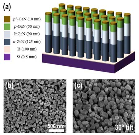

Recently, researchers from the King Abdullah University of Science and Technology (KAUST), led by Xiaohang Li, Boon S. Ooi, and Iman S. Roqan, studied the photoinduced entropy of InGaN/GaN p-i-n double-heterostructure nanowires (shown below) using temperature-dependent photoluminescence (Applied Physics Letters, "Photoinduced entropy of InGaN/GaN p-i-n double-heterostructure nanowires").
They defined the photoinduced entropy as a thermodynamic quantity that represents the unavailability of a system’s energy for conversion into useful work due to carrier recombination and photon emission.
They have also related the change in entropy generation to the change in photocarrier dynamics in the InGaN active regions using results from time-resolved photoluminescence study.
They hypothesized that the amount of generated randomness in the InGaN layers as the nanowire eventually increases as the temperature approaches room temperature.
(a) Schematic and layer structure of the InGaN/GaN p-i-n nanowires, (b) plan-view, and (c) elevation-view SEM images of the nanowires. (Image: KAUST)
