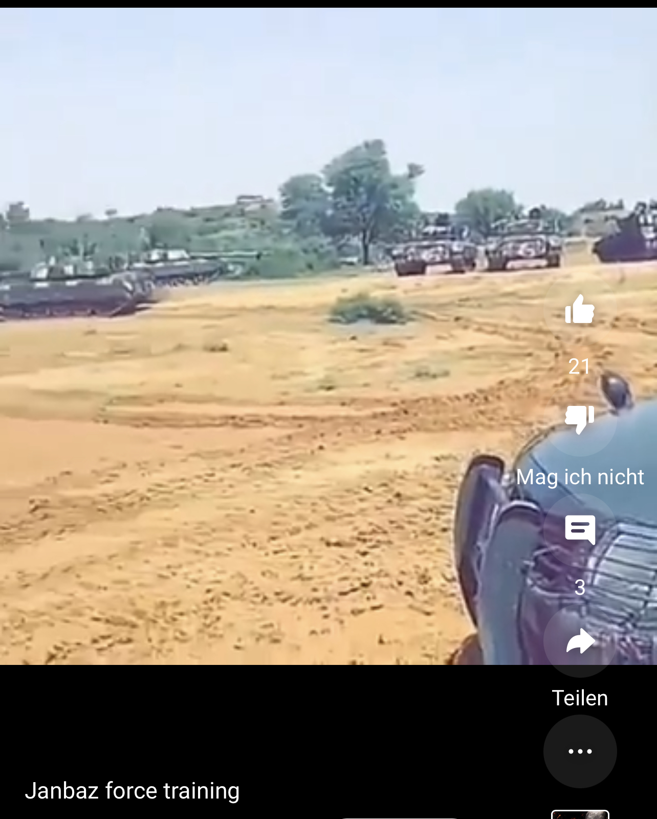

@Signalian As you highlighted many years ago how important armoured reserves are, the actual Ukraine-Russian war is showing more then anyone could think, Russia has activated T-62 series now T-55 and even T-34, while Ukraine has the Leopard-1 in frontline. I still support your concerns and concepts of building Tank reserves, after watching this Ukraine-Russian conflict, I write again that tank reserves should be a essential part of any war plannings. What I have seen and read about the actual ongoing eastern war theatre, Tank to Tank battles have been less than expected in Russian- Ukraine war, so there should not be any shy to charge older generation tank coupled with storm infantry. More then the strategic reserve argument, is the availability of 24 hour close fire support, which the Germans had mastered in world war 2 through their Sturmgeschütze and Hetzer series, related to Pakistani armoured Corps, I would suggest to put every single Tank which is retired in workable storage conditions. The impact of such a reserve force on the battlefield is magnificent, the Israelis had fought and won most of their wars with reserve forces/national guards, the German Wehrmacht had knocked out more modern Tanks with older equipment, then anyone can imagine. Janbaz Forces should be equipped and trained with Tank assault squadrons made of older type of Tanks. Even the regular infantry Battalions should get such attachments of retired tanks. Now criticism and thoughts please.
@iLION12345_1
Janbaz Force/National Guard on Training with third tier Tanks
@iLION12345_1
Those are army tanks they are training with. I see Al-Zarrars and Type 59s both.
That’s why it is imperative to quickly retire older tanks, because these tanks then end up in reserve and long term storage. Which means the best way to build a reserve is also to modernize. Now imagine if PA can buy enough VT4s to replace Al-Zarrars as well? That would create an extremely powerful reserve force. Most of indias armor reserve is currently composed of T72s, which are still superior to Type 59s and 69s.
All the Type 59s and 69s being retired due to induction of VT4 are being rebuilt and then put into cold storage as reserve tanks. Before the induction of VT4 started, Pakistani armored reserve was much smaller.
