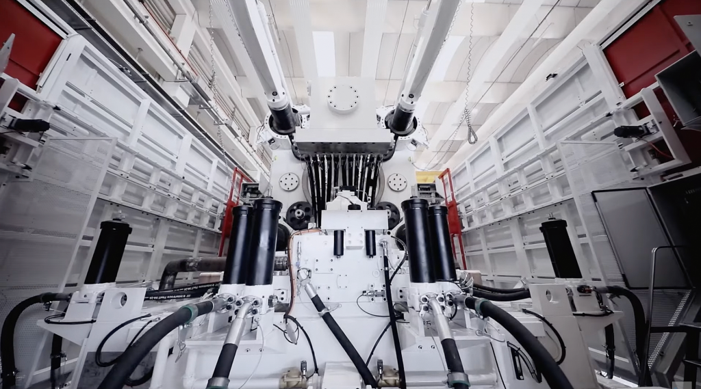

WHAT IS GIGACASTING?​
The Giga Press is an aluminium die-casting machine adopted by Tesla at its factories in the U.S., China and Germany. The house-sized machines are able to produce aluminium parts far bigger than anything used before in auto manufacturing.
The "giga" in the name is a nod to Tesla's convention of calling its plants "Gigafactories". Other automakers have taken to calling them "megapresses", which also can refer to smaller but still massive machines.
In operation, the press takes in a shot of molten aluminium of 80 kg (176 lb) or more into a mould where it is formed into a part, released and then quickly cooled.
Tesla has developed an aluminium alloy that also allows it to skip the heat treating traditionally used to increase the strength of the cast part.
