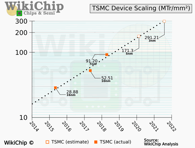

As WikiChip reports, TSM disclosed that its N3 will feature a 1.7x density improvement compared to N5, which just entered production. TSM says N3 will provide 10-15% speed improvement at iso-power or 25-30% power reduction at iso-speed; quite standard claims for a new process.

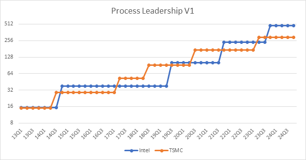

The graph below shows WikiChip's numbers for TSM:
This confirms my statement that TSM N3 will be very close to Intel 7nm - N3 has just a 21% higher density. This results in following comparison:
Just a few quarters later, at the end of 2023, Intel will move to its 5nm node with a 2x improvement in density.
The graph above shows the extremely long period Intel remained at 14nm, which allowed TSM to leapfrog Intel with the introduction of its own N10 and N7. Intel achieved parity, or a slight edge, with TSM midway TSM's N7 cycle (where we are now), although Intel's 10nm is still quite limited in volume. TSM is charging ahead to 5N later this year but will stay there for a more prolonged time, allowing this time Intel to leapfrog TSM with 7nm and 5nm shortly after 3N.
This means from 7nm onward, Intel will take the process lead back and have the most dense process for the majority after that period; TSM will only have the lead for a few quarters in 2023, by a small margin. This means TSM's four-year process leadership that started in H2'17 will end in H2'21.

Still, Intel seems to have a higher pace of improvement: Intel's 5nm will launch a few quarters later, moving to nanowires/GAA and a density that is much higher than N3. Assuming no delays from either side.
TSM benefited hugely from Intel's historic 10nm delay, and N5 just entered production at least a year before Intel's 7nm, but its process leadership days seem numbered.
