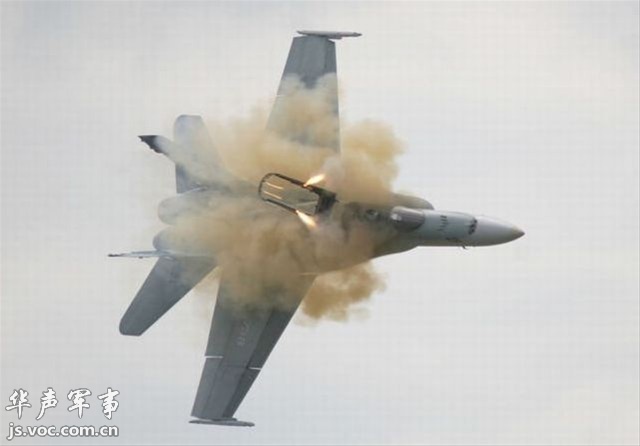

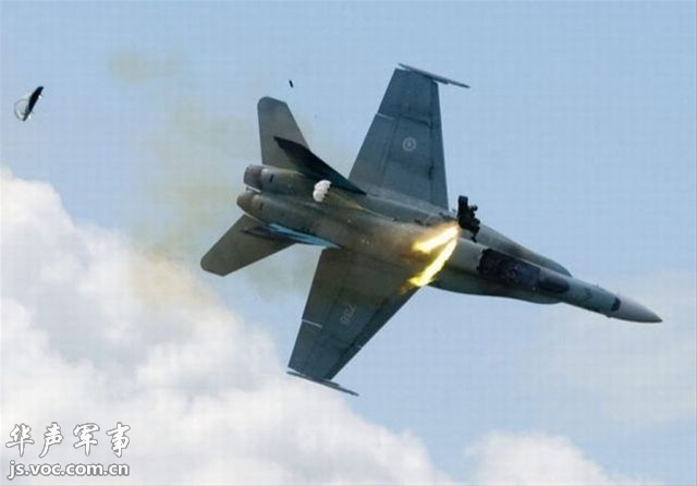

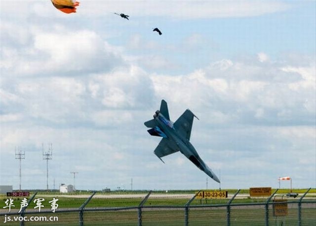

F-18 with a full fly-by-wire (FBW) flight control system (FLCS), is that work ?:coffee:
The lost of three Chinese pilots is very normal during China learning how to operate A.C and J-15 ... as long as China Navy having A.Cs on the sea, no doubt there will be more casualties as many as U.S Navy had during past half-century, Did American avoid thousand casualties on the A.C deck or in training ? NO.
J-15 is a good fighter for PLAN, better than nothing ... it's China 1st-gen carrier-borne jet fighter, without first there no next, the J-15 keep going.
