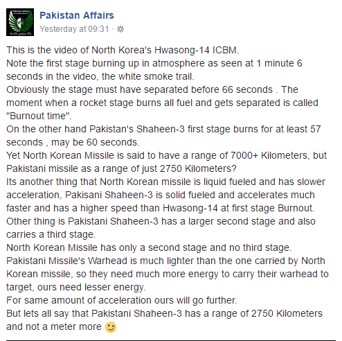

@The Deterrent @amardeep mishra @The Accountant @CriticalThought your comments
Hi @Narendra Trump
I cant view the original video, but there are various factual inaccuracies and I will try to correct them, but as I can see, @The Deterrent has done most of the job.
1) The white smoke trail you see is actually due to pressure difference, as you go up, the atmospheric pressure falls off drastically and hence the density, there will be a point when the density of exhaust will be higher than the density of the local atmosphere. Also kindly note, the nozzles are designed to operate "optimally" in a certain altitude zone. What I mean by optimality is the fact that when your rocket(nozzle) operate in this altitude region, you'll have least possible divergence losses from the nozzle, in any other case, there will be either over expansion or under expansion.
2) Burnout time is not the real measure of range of the ICBM, what matters in defining the trajectory or range are-
(a) Burnout Altitude
(b) Burnout Angle
(c) Burnout Velocity
The burnout time depends on the acceleration of your motor, if lets say you've a motor with very high ISp values, then you'll likely have a lower burnout time. Also it depends on the amount of fuel carried on-board--which in turn dictates the size of the rocket.
3) It is patently false to assume that solid motor has higher Isp than liquid motor. On the contrary even the most primitive liquid motor comprising of N2O4/UDMH has higher Isp than a solid motor of similar mass. In fact liquid in general burn much more "uniformly" and emit lesser unburnt particles vis-a-vis solids. The Isp figures progressively increase as we move from UDMH(hypergollic) to LOX/kerosene(semi-cryogenic) to LOX/LH(cryogenic). However there are various pros and cons of using liquid engine-
for starters--Pros
1) It has much higher thrust and lesser unburnt particles
2) Throtleable i.e the thrust can be controlled
Cons
1) Takes enormous amount of time to fill the tanks.
2) In case of hypergollics, the constituents are highly corrosive and dangerous, In the case of cryogenics, the technology required is very complex.
3) Generally require a lot of volume.
In the light of last three points, it is advisable from operational perspective that ICBMs be fuelled by solids rather than liquids. Thereby reducing the reaction time to launch a ICBM. With canisterization, the prep times can be further lowered to just a couple of mins. It is rumored that A-5 can be launched in as less as 10mins! But there are a whole range of issues that crop up when you have to store you missiles in a hermetically sealed silo for extended duration of time. Those issues might range from how to fill the RCS tanks to the type of metal alloys suitable for those tanks etc, etc.
