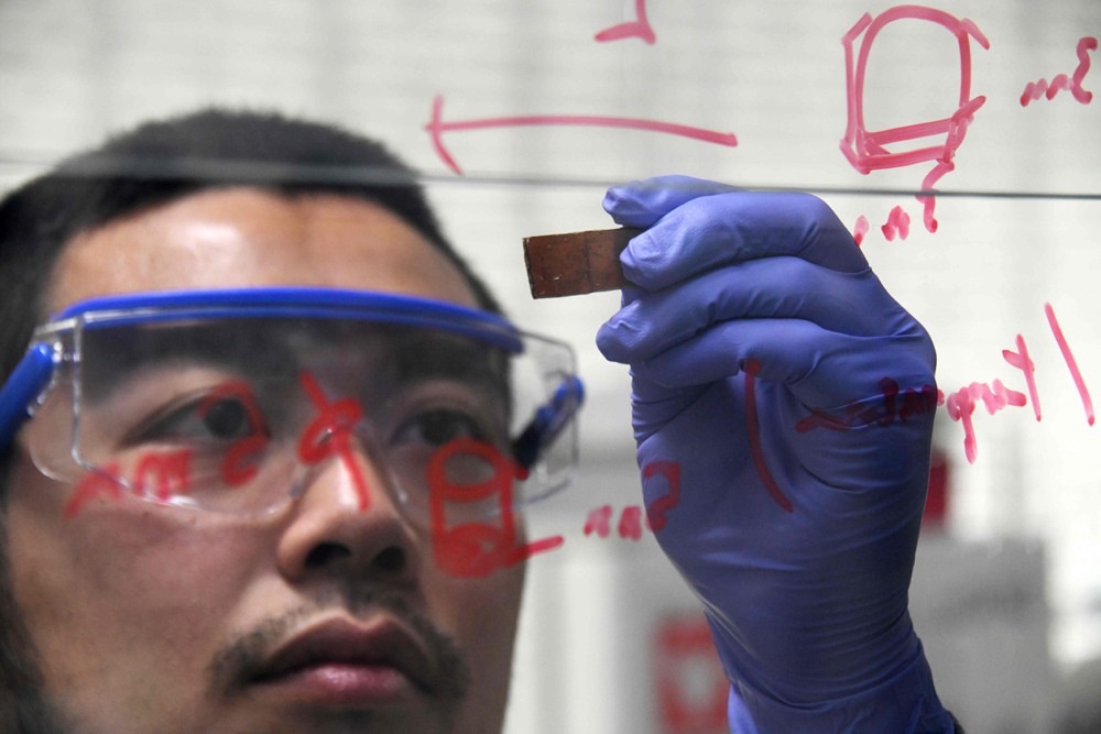

Yu Yanagisawa, a chemistry researcher at the University of Tokyo, made the breakthrough by chance while investigating adhesives that can be used on wet surfaces.

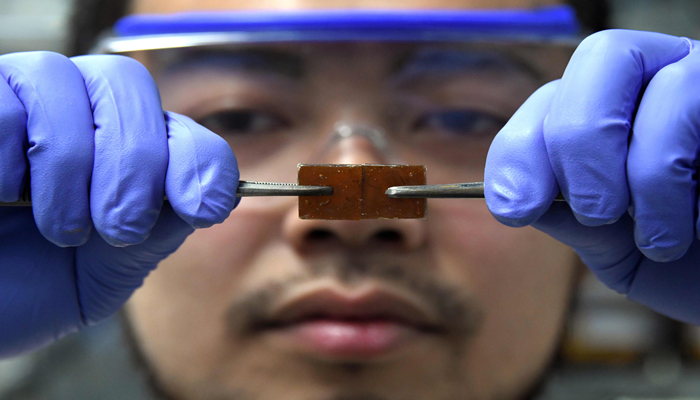

In a lab demonstration for AFP, Yanagisawa broke a glass sample into two pieces.
He then held the cross sections of the two pieces together for about 30 seconds until the glass repaired itself, almost resembling its original form.
To demonstrate its strength, he then hung a nearly full bottle of water from the piece of glass -- and it stayed intact.
The organic glass, made of a substance called polyether thioureas, is closer to acrylic than mineral glass, which is used for tableware and smartphone screens.
Other scientists have demonstrated similar properties by using rubber or gel materials but Yanagisawa was the first to demonstrate the self-healing concept with glass.
The secret lies in the thiourea, which uses hydrogen bonding to make the edges of the shattered glass self-adhesive, according to Yanagisawa´s study.
