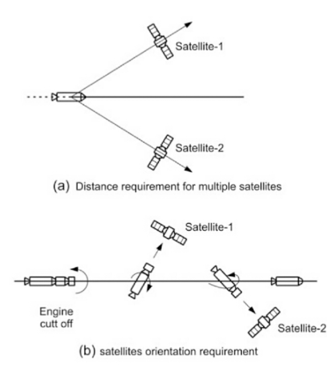

I am sure ISRO knows better, but I thought a gap of about 2-3 seconds between each satellite ejection, would have all but ensured that there would be no collision between them. I suspect such a spacing would also ensure more economic burning of their internal fuels used up for the evasive maneuver that they most likely carry out immediately after their ejection.

This is one of the factors that make multiple injections difficult. This will give you a new appreciation of ISRO putting 104 satellites together in orbit. This is why the "haha most were nanosatellites" argument is nonsense and why the CIA said that it's alarming.
When there are multiple satellites, each are injected after reorienting the final stage so that they're in close but separate orbits. Separation velocities and launch sequence are carefully chosen.
This is not as simple as it sounds. Calculations must be done for the entire lifetime of the satellites. In fact this is the reason behind the reorientation and a proper time interval. Indirectly, this will also avoid collision at the time of injection.
But calculations aren't limited to this.
Even the possible plume interactions from the final stage and reaction control thrusters must be studied.
Another factor to consider are the possible dispersion in the separation system parameters. We've to analyse what the position of each satellite/stage are at different times in the future. This relative distance changes in time as shown:

I have no illusions about the complexity involved and like I said, ISRO knows better. I also know in a limited way how satellites reorient themselves after deployment in an initial parking orbit that include both static (using solar panels for drag over course of months) and dynamic methods that use rocket fuel.
But I was thinking if spacing the deployment with several seconds in between (instead of spacing of fraction of a second) would be more practical and if so, may result into faster reorientation since the satellites need not worry about collision as much as they need to do now.

Parking orbit is a different concept and applied when we go to geostationary or lunar or interplanetary orbits. We go to temporary orbit and then go to another. Not the case here.
Also, this reorientation is done by the final stage of the rocket, not the satellites. So there's no question of collision at the time of injection. Satellites don't need time.

Perhaps, my usage of the term "Parking" orbit may not be entirely accurate here, but I am only referring to the temporary physical location of the spacecraft immediately after it is ejected out by the launch vehicle before it's final place of deployment. I am fully aware that an interplanetary mission is different than a simple earth orbiting satellite. No need to mix the two.
Not sure of the point of the debate here, but even as a noob I can tell you that reorientation has to be done by each individual satellite - especially when you don't have a dedicated launch vehicle for any one particular satellite.
BTW, the reorientation I am referring to is only the deployment of the satellite such as to allow maximum solar exposure, best antennae/camera/sensory alignment that is effected by the reaction wheels using it's Star Sensor for reference.
As you can see below, reorientation is something that an individual satellite has to do on it's own since there is no way the launch vehicle can reorient a whole flock of satellites that essentially tumble out of the launch vehicle spinning "seemingly" haphazardly.
