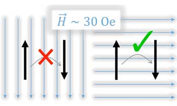

The increasing miniaturisation of electronic circuits and storage media is progressing steadily. But how small can you actually make a ‘bit’ of information? Is a single atom sufficient to write 0 and/or 1 and freeze its state? The magnetic moment of single atoms or of small clusters actually makes this possible. It acts like a tiny bar magnet, which allows only two possible orientations: Either the north magnetic pole is pointing upward or downward. Between both states there is a high energy barrier, which makes it difficult to switch and prohibits orientations in the middle.
But now quantum mechanics allows a shortcut: Instead of laboriously climbing over the energy barrier, you can simply tunnel through it. However, there are some things to keep in mind: The energies of the two states such a tunnelling process is taking place between must be exactly the same, which is also called degeneracy. With an externally applied magnetic field, this can be cancelled, blocking the tunnel path. This freezes the orientation of the magnetic moment.
Depending on the orientation of an applied magnetic field, quantum tunneling of the magnetisation allows to either freeze or to flip magnetic moments. (Image: University of Augsburg/IfP/EKM)
Only 0.003 Tesla instead of one

But they have not only been successful in suppressing the quantum mechanical tunnel effect, the opposite has also proved possible: If the external magnetic field is applied in certain directions, i.e. perpendicular to the imaginary line between the iron and its two neighbouring atoms, the tunnelling rate can even be significantly increased. You can either freeze the magnetic moment or encourage it to flip in a specific direction.
