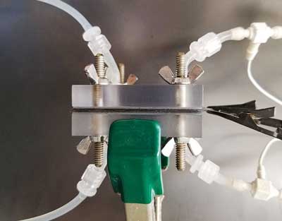

A feed solution contained in a reservoir was separately fed to the two inlets of the flow cell using pumps, one desalinated and the other concentrated. This is achieved by applying electrical current to the flow cell through wires using a power source (not shown in this photo). The conductivity of the discharge was then measured using flow conductivity meters located at each outlet, which were monitored by computer. (Image: Taeyoung Kim) Standard CDI techniques desalinate water by separating the water’s ions. A typical CDI cell consists of two electrodes attached on opposite sides of a flow channel. The electrodes capture the salt ions through electrical exchanges that occur when an electrical current is applied to the cell. The cell is then regenerated by releasing the salt ions in a second cycle by alternating the direction of the applied electrical current. Since CDI does not require membranes and has lower energy requirements than other popular methods, it is becoming a competitive technology for removing salt from water. The problem with CDI systems is that they are limited by low salt adsorption when using the typically applied 1.2 volts. Increasing the applied voltage does improve the salt adsorption, but it also increases the potential for unintended side reactions that waste energy and can create permanent electrode corrosion.
In the team’s newly developed BDI system, a custom-built flow cell utilizes two channels. The channels are separated by a membrane and two identical battery electrodes are secured at each end.
