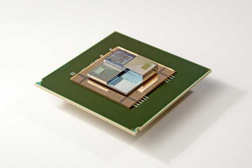

Three-dimensional chip stacks could be used in computers in the future. Integrated microscale flow batteries could both power and cool them. (Image: IBM Research Zurich) (click on image to enlarge)
"The chips are effectively operated with a liquid fuel and produce their own electricity," says Dimos Poulikakos, Professor of Thermodynamics at ETH Zurich. As the scientists use two liquids that are known to be suitable both as flow-battery electrolytes and as a medium to also effect cooling, excess heat can also be dissipated from the chip stack via the same circuit.
The battery built by the scientists is only around 1.5 millimetres thick. The idea would be to assemble chip stacks layer by layer: a computer chip, then a thin battery micro-cell that supplies the chip with electricity and cools it, followed by the next computer chip and so on.
