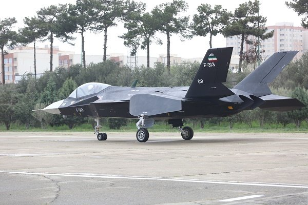

however, the prototype that did the taxi test had already undergone some modifications, it is twin-engine and the dimensions have changed

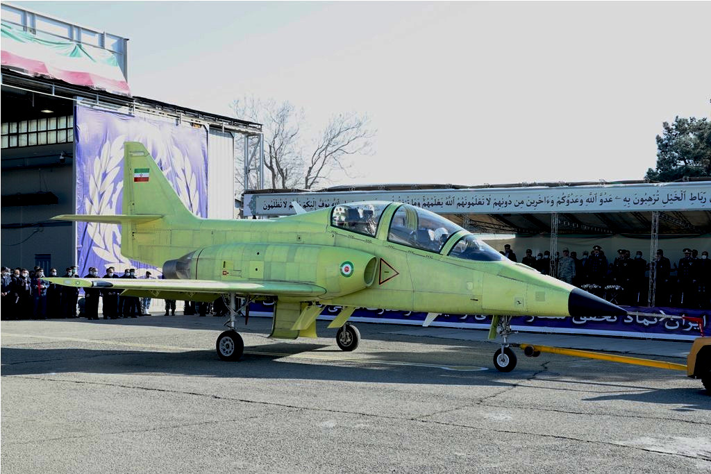

Yasin is sub-sonic , its good as experience with serial production of homegrown design but the spec is too low to spend so much money on it ...
it can fill some gap in our need , but we shouldn't spend so much on it because its domestic ...

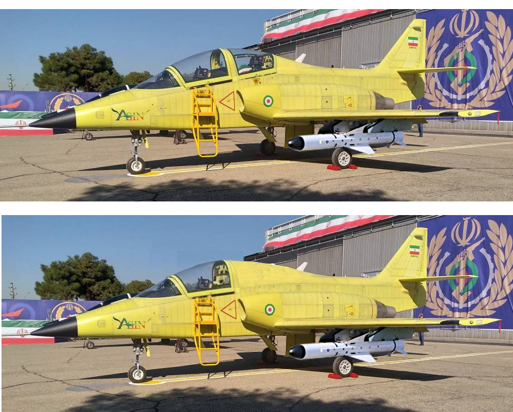

while Iran has several types of anti-ship missiles in its arsenal, some of which may be suitable to mate with Yasin's pylons.
Just out of personal curiosity I played with the images, including a Yasin single-seater

Armed Yasin is definitely in official plans..I was reading some details of Yasin# 2..by the chief designer..he mentioned #2 has 'wet wings" and cockpit is full glass cockpit...but interesting you never see a photo of Yasin cockpit...looking forward to see it...have you seen any photo of it..
