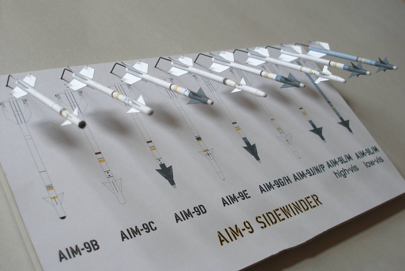

you see there is at least 5 generation of AIM-9P and as far ad i'm aware compared to AIM-9J they used a new engine in it and it use newer electronic , that new engine resulted in longer range for aim-9p compared to aim-9J

by the way are you sure we get AIM-9J for our F-14 not AIM-9G/H ?
AIM-9J was an air force weapon while AIM-9G/H was a navy weapon.

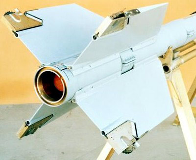

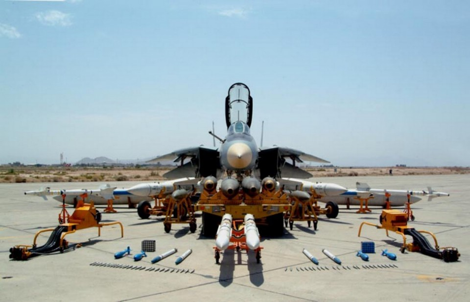

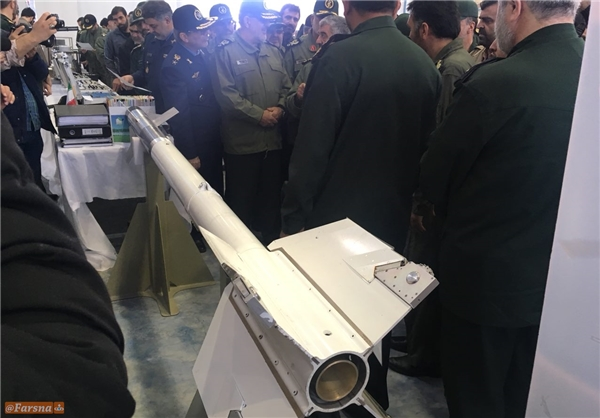

AIM-9J and AIM-9P have no difference in ranges. They are the same missile except for all aspects InSB seeker in AIM-9P. Dr. Carlo Kopp who ran Aussie air power says the same. Later AIM-9P4/5 versions had different motors from the same manufacturer but the range remained the same. Fatter has not much of a range enhancement either if you ask me. AIM-9J/P has an effective range of 36 KM. If fired at a higher speed may be more. So Fatter's 40 KM is well within that domain. The range change in this family only occurred in the last decade with AIM-9X Blk II/II with USN saying that range has been enhanced by 60+ % which translates to ~ 60 KM. So even if a USN F-35 or F/A-18 is flying with just Blk III sidewinders it's still capable of attacking the enemy at BVR ranges. Fatter with the same strategy of more fuel, dual (midcourse+terminal) guidance, FPA imaging IR can turn into a deadly BVR weapon for Kowsar-I/II fleet and future A2A UCAVs.
So while they are throwing in money for Fakour-90B and Maghsoud while also purchasing probably PL-12/15 from china in the future (not sure). They have all the ingredients of a dangerous BVR missile at their hands if Fatter undergoes some R&D.
Mind you AIM-9P was or still is the primary killer of NATO AF. They won the war for RAF over Argentina where slow Harriers murdered the Argentina 2 Mach+ Mirages in the air with it. AIM-9P also scored heavily on Iraqi Migs.
IRIAF has never been seen with anything other than AIM-9J or its driven Fatter. Look at the canards and you find nothing but originally supplied AIM-9J or Fatters. Operational Fatters have shiny steel rollerons on tail fins while practice rounds have no rollerons and have blue markings.
Fatter/Azarakhsh Fin section is bit differently constructed from a conventional AIM-9P/J

about AIM-9J and AIM-9P have the same range i have my doubt ,every source i look say 9P is an Improvement over 9J and state one of the improvement is range and engagement envelop.
but honestly hear i can't be sure because very few source make any distinction between AIM-9P1 to AIM-9P5
The AIM-9J, a conversion of the AIM-B and E models, has maneuvering capability for dogfighting, and greater speed and range, giving it greater enhanced aerial combat capability. Deliveries began in 1977 to equip the F-15 and other Sidewinder-compatible aircraft.
The AIM-9P, an improved version of the J model, has greater engagement boundaries, enabling it to be launched farther from the target. The more maneuverable P model also incorporated improved solid-state electronics that increased reliability and maintainability. Deliveries began in 1978.
The AIM-9P-1 has an active optical target detector instead of the infrared influence fuse; the AIM-9P-2 added a reduced-smoke motor. The most recently developed version, the AIM-9P-3, combined both the active optical target detector and the reduced-smoke motor. It also has added mechanical strengthening to the warhead as well as the guidance and control section. The improved warhead uses new explosive material that is less sensitive to high temperature and has a longer shelf life.
but don't knew you may be correct , externally the missiles are nearly identical , except you can Fire AIM-9J only toward enemy tail , while AIM-9P can fired from any angle
In your own pasted links, nowhere it is written that AIM-9P and J have different ranges. Read again the author is describing that AIM-9P versions have solid-state electronics, low smoke motor, and in P4/5 we have an InSb detector for all aspect attacks that is it. Same range, same canards, fins, weight.
Fattar is just Iranian AIM-9P equivalent (that IIAF never received) with a slightly modified fin section. What makes it 3 Kg heavy is probably its seeker. Iranian companies love to play with seekers and motors while retaining the aerodynamics to some degree.
Fakour-90 retained AIM-54 shape but seeker got changed
Fatter is AIM-9J/P with different seeker

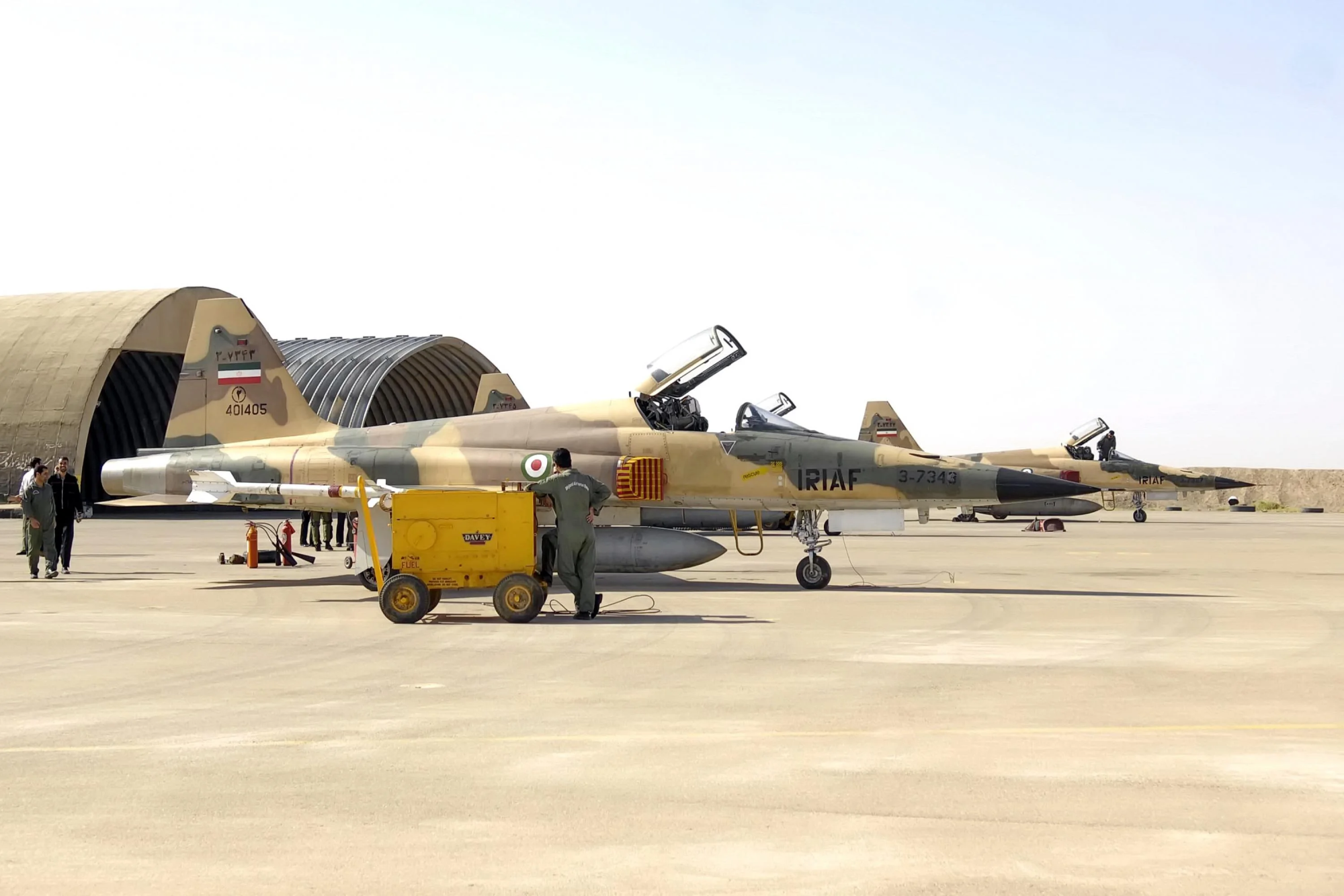

I have wondered that too, I guess it has more to do with traditions? IIAAF used splinter camo on all their fighters, IRIAF carried that tradition on. Currently its like,
Splinter for F-14AM, F-4E/D, Kowsar, F-5E/F/A/Saeghe, SU-24M, F-7N
Grey/Sky blue for F-14A, RF-4, MIG-29, Mirage F-1
White for of Simorgh F-5B, F-7N
Green for SU-22 (IRGCAF), Azarakhsh prototype
Bue angels Navy blue for Saeghe and Kowsar prototypes

but about the color
the idea is to avoid detection the airplane can dive and fly close to ground under the eye of Radars and meanwhile virtually become invisible to any airplane flying above
The regular camo of USAF and USN is grey/silver
Also the middle eastern airforces in splinter camo was true in 1970s and 80s. But not anymore because camos do not matter in this BVR and stealth combat aviation age. IRIAF is just run by people who have zero interest in that force or are isolated from the rest of the world. These are the fighters of all middle eastern countries around Iran. Splinter camo was a thing of past, nobody uses it anymore.
Its weird tbh to have such clownish colors on war machines, IRIAF/IRGC-AF should go all American Sky-blue with black/Grey radomes. It looks decent for aircraft and makes things look professional. It also tells us what kinds of jokers are occupying decision-making seats in IRIAF. These people are caught up in 1970s-80s when even these track-suit camos were common around the world on military planes. Fortunately, they have not done the same to the UCAV fleet which is just single-tone off-white or Grey/Light blue.
This should be future IRIAF camo with Kowsar-I/II, MIGs, F-14AM.
