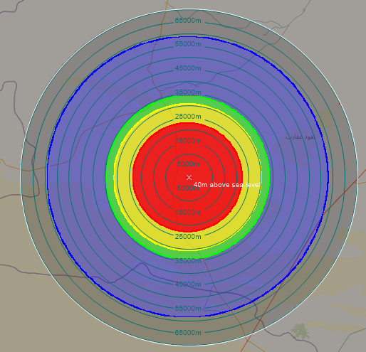

To get well founded information and confirm this assumption I Used an Open Source Radar Coverage Simulating tool from Cambridge pixels (free download after email verification) and analyzed first the Israeli Point of View in terms of Radar:
The Radar Coverage Tool shows the Coverage of a Radar on a specific location in different heights (values can be edited in the program).
Legend:
ColorHeight Coverage meters over Ground
Red0m
Yellow5m
Green50m
Blue100m
Black1000m
Radar Coverage somewhere in Saudi Arabian desert near iraqi border. Flat terrain and no mountains.
Note that Mountains and valleys are disorbing the coverage and also Radar Height plays a important role.

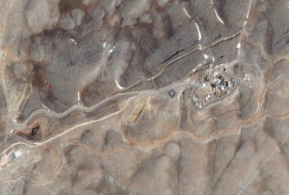

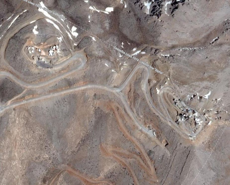

Used different maps to find already existing Israeli Military Areas and EW Radar Site. One Site is located on the Golan heights and it seems that there is a stationary EW Radar.
Location of the most effective Israeli Sites in regards of Syrian Airspace observation are:
1.) 33.315679677381, 35.809110418906
Source: Google Earth
2.) 33.304466260578685, 35.79751431755392

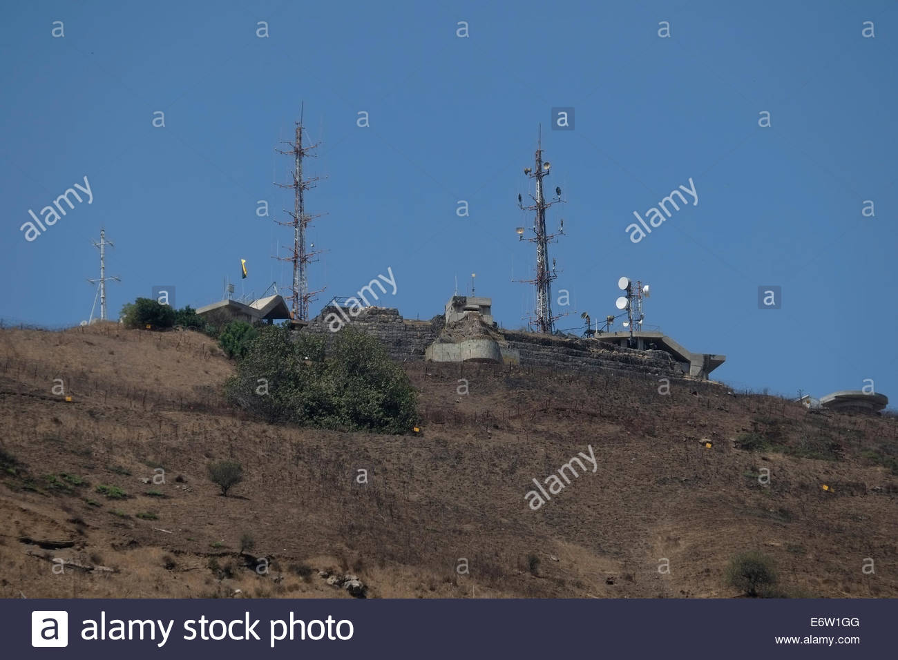

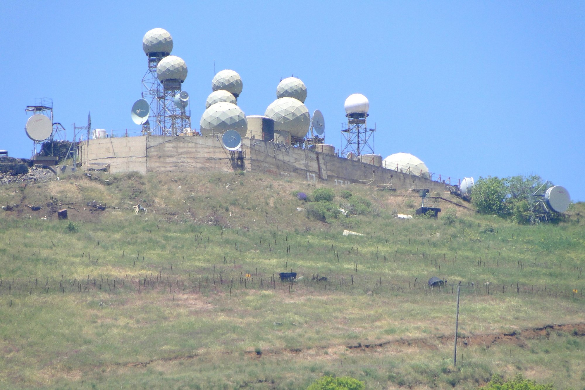

Here are some closer Images of the Radar sites itself:

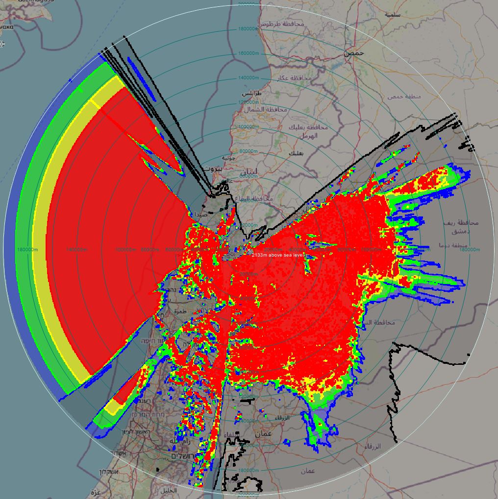

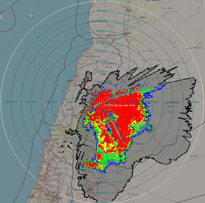

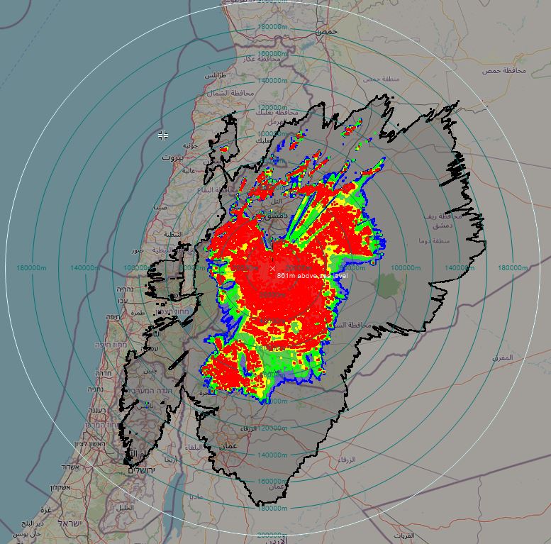

If we Simulate Radar Coverage of these Radar Stations we will recieve following Result:
We can clearly Observe that Israel is capable of oversee not only parts of south lebanon, but also far beyond Damascus deep inside Syria on a 0 meter level. Theese early warning Radar Stations have the capability of detecting any movement on the ground level. if a Syrian fighter Aircraft rolls out on Damascus Airport, Israel will be able to see it.
There are also other Locations on the Golan heights on wich non Stationary Radars can be deployed wich will end in a comparable result.

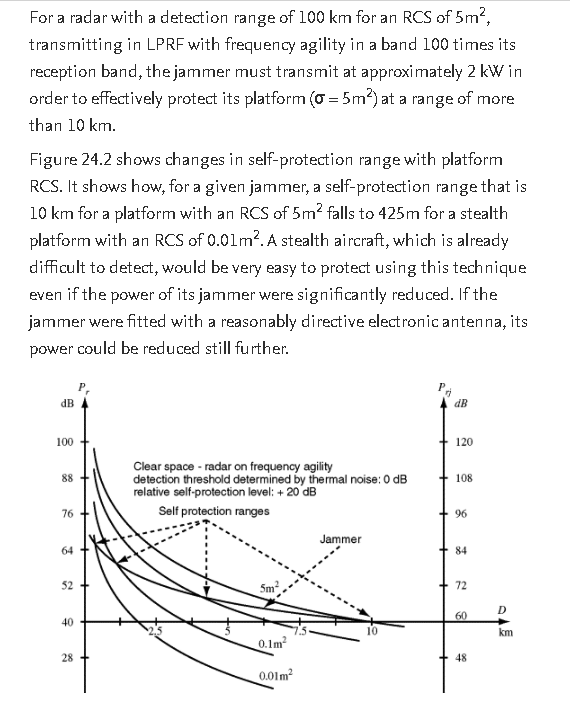

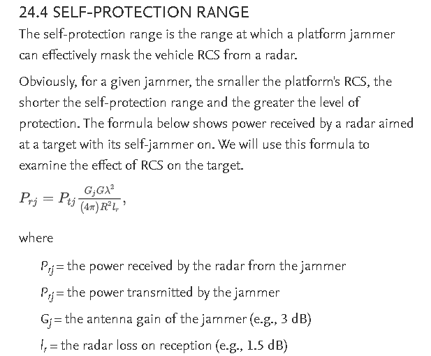

  • Jamming capability of Israeli Force will reduce Radar Capabilities of Syrian Forces even more. Jamming Range of Israeli Aircraft are unknown to me and shure will depend on Radar Power of nearby Air defence Radar Systems in Syria. For Example, an Bavar 373 Radar System will definitly force the intruding Aircraft to a bigger self protection range to the radar site than an S-200 System.
    Source: Jammers - an overview | ScienceDirect Topics

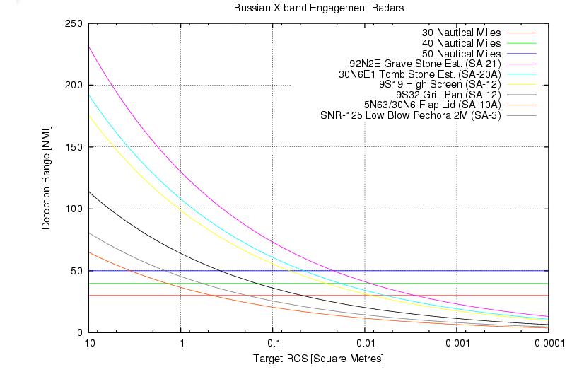

  • Use of Stealth Technology by the Israeli Airforce will reduce Radar Capabilities of Syrian AD. Optimum RCS of Israeli F-35 is according to Open Source: 0.0001 m². We have to take into notice that this RCS is only reached under best conditions, best angle of attack and best height.
Source: Engagement and Fire Control Radars (S-Band, X-band) (ausairpower.net)

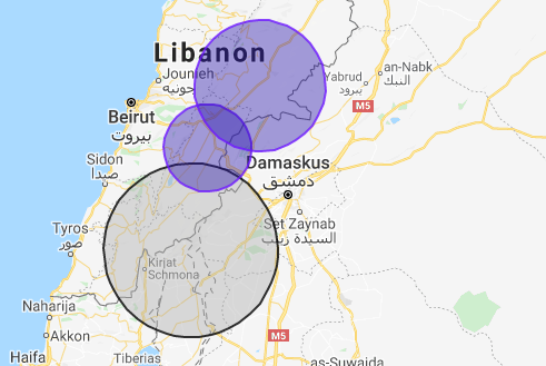

I believe that nearly all the Israeli Airstrikes near Damascus were supported by massive Jamming of the abovely named Radar Sites.
Possible Jamming Area when Israeli Jets are flying attacks on Syria from Golan heights and lebanon:
Blue: Possible Jamming Area from incoming Jets with Jamming Pods (self protection range from radar included.)
Black: Possible Jamming Area From Israeli EW Radar Site

+ Self protection distance of enemy aircraft will be increased, this means that when they fire their missiles thowards their targets, short Range and CIWS have more reaction time,

EW Systems against this israeli Radar station
+ Radar Capability of Israel will be reduced
-own or allied Radars will be maybe jammed too. Already happened in the past cause Syrian S-200 were too old: Iran Paralysed Syrian Defense Systems During Israeli Strikes: Source - The Syrian Observer
Destroy that Israeli Radar site completly
+ Israeli Radar coverage over Damascus ends
+ Destruction is realistic and can be done very cost effective. Its also close Syrian boder. Only some single meters away from it
+ Best option is doing it during a war or a next Israeli Airstrike
- Unknown Political consequences
- Unkown israeli Reaction (escalation level unknown)
